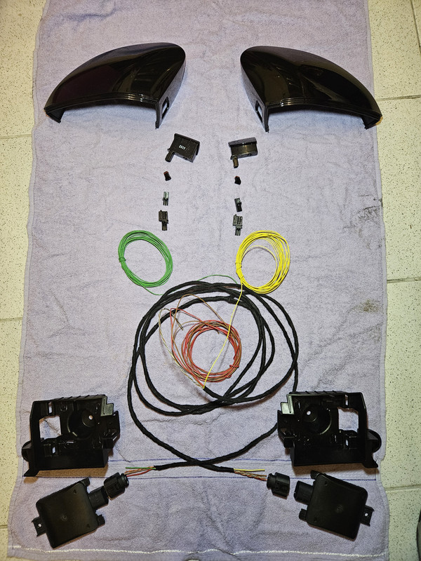

I have decided to retrofit Blind Spot Assist myself. I am currently gathering information and materials.
I will share my efforts with you as they unfold. I don't know if I will succeed, so I haven't yet predicted 100% success.
The information concerns material codes and  the method of their installation.
Finally of course there is the programming of the system which will be done by on-line connection to the VW servers.
So, so far I have collected some materials.

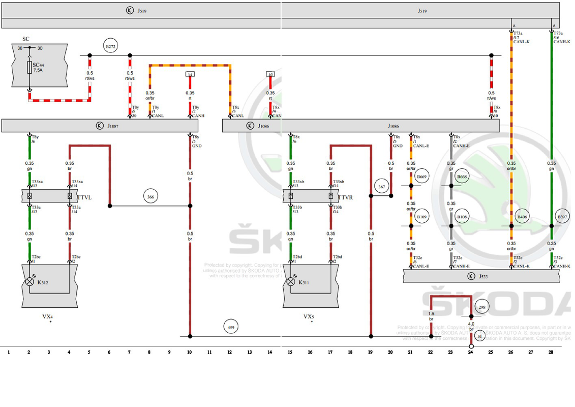

The schematic:

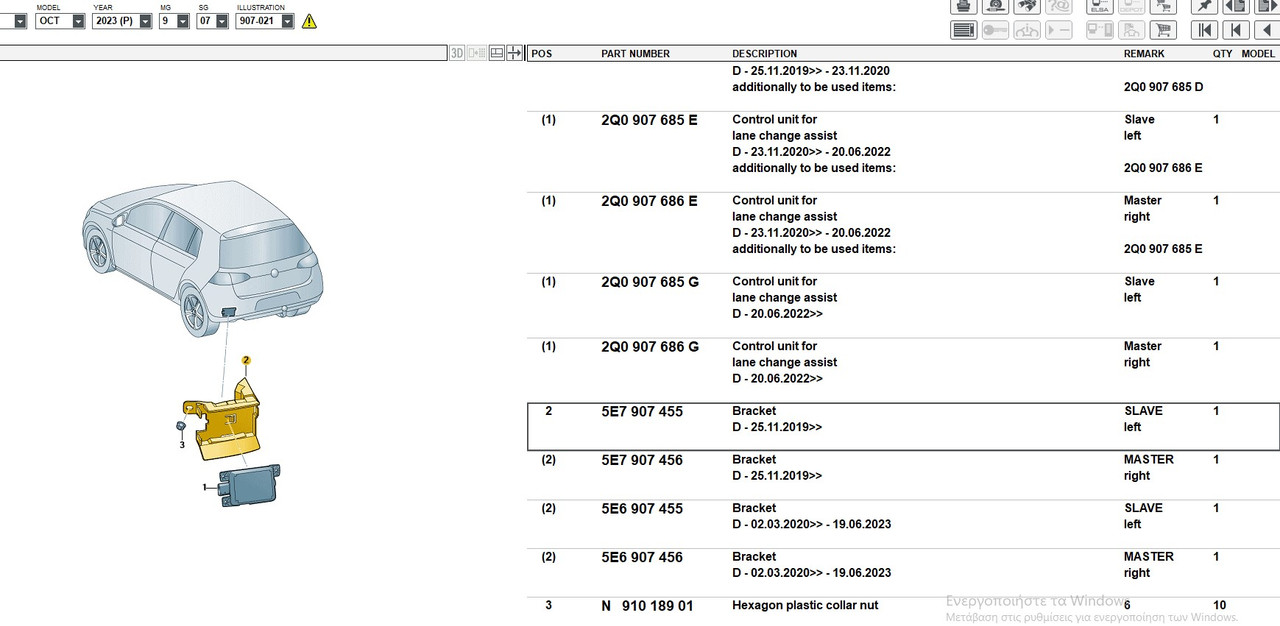

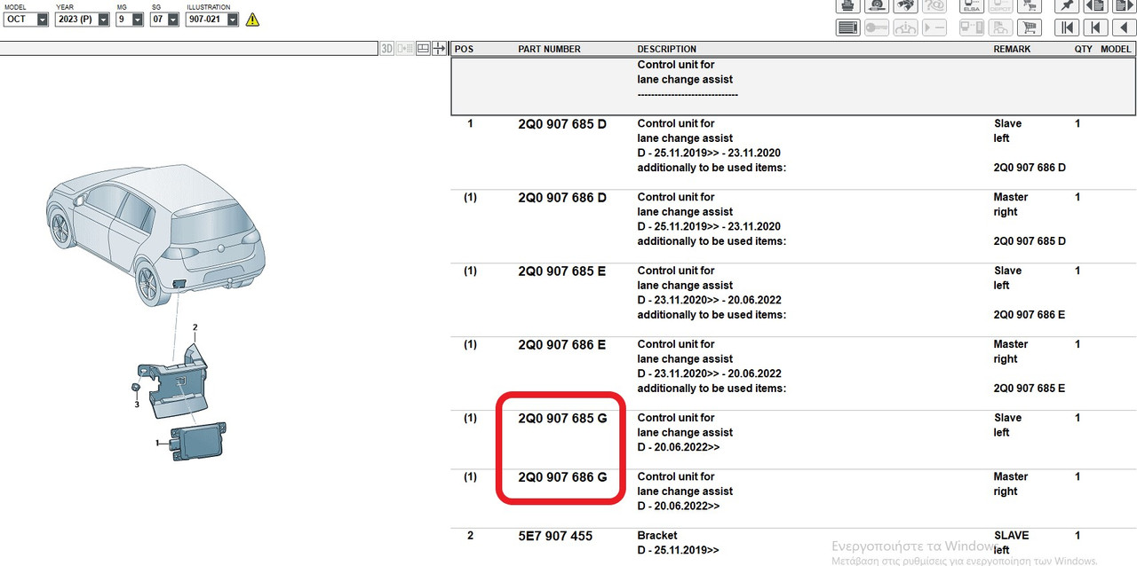

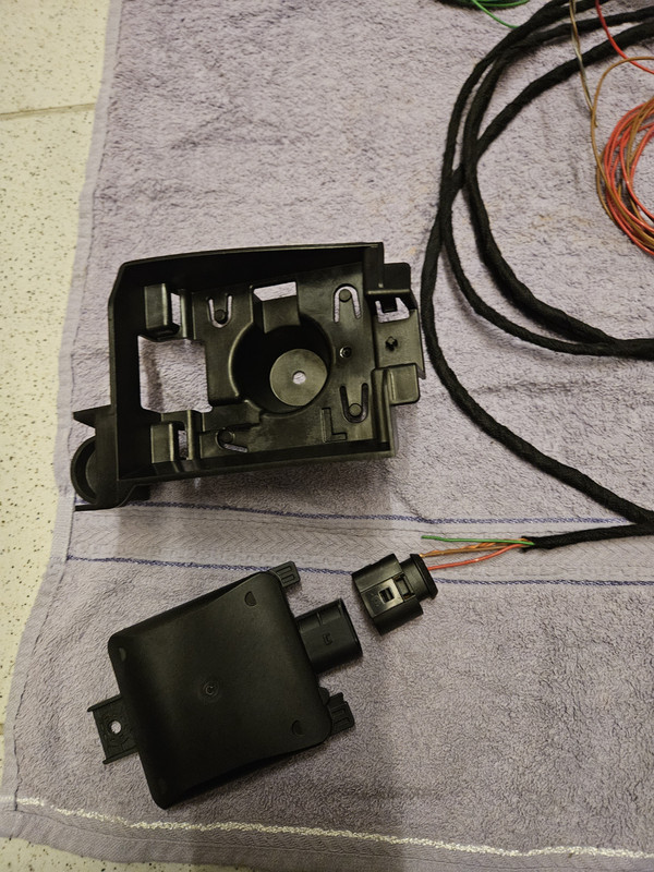

The codes of the radars:

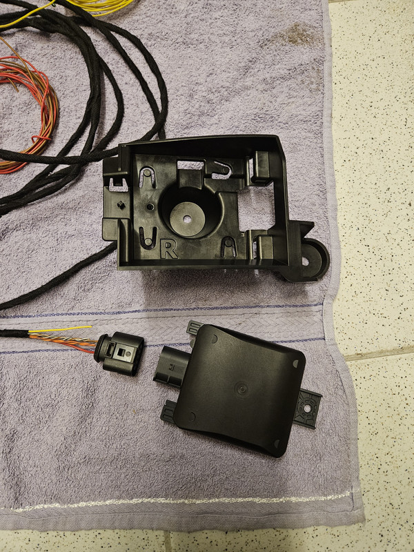

The brackets for the radars

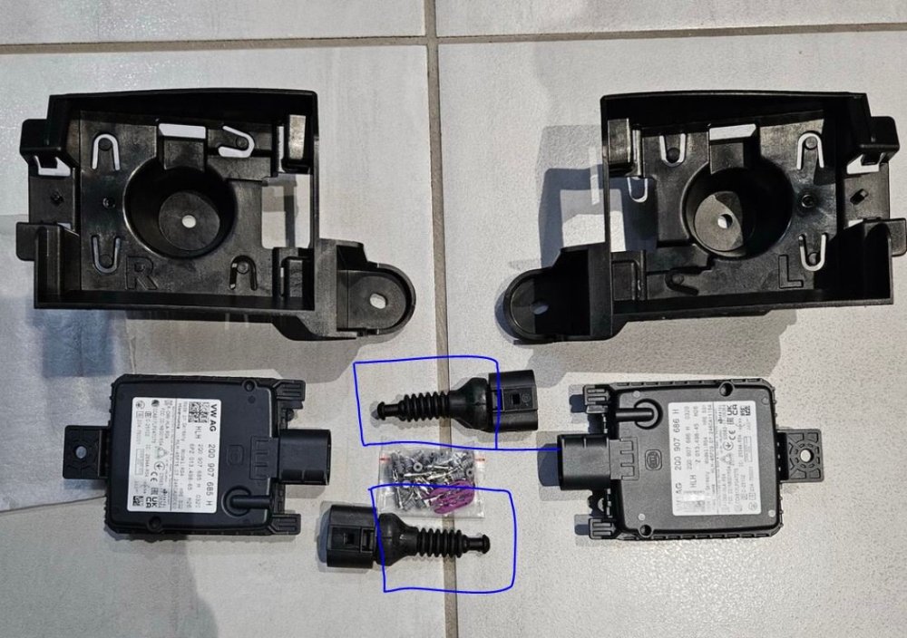

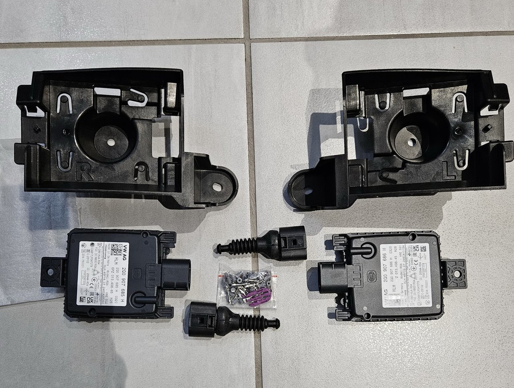

  • I  am almost done with the materials.  Here the most important.      Left radar 2Q0907685H  Right radar 2Q0907686H (master) Bracket on the left 5E6907456A

I made it according to the electrical schematic (i posted it at my first post).

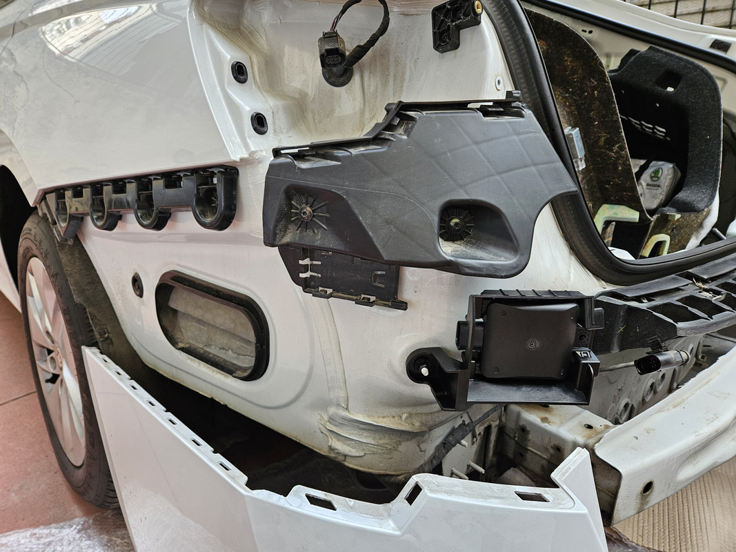

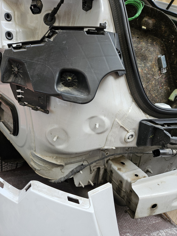

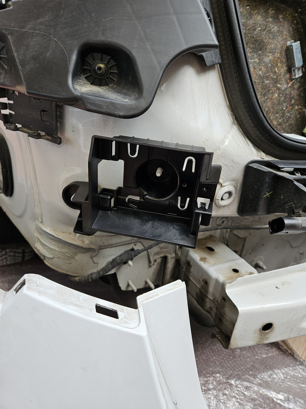

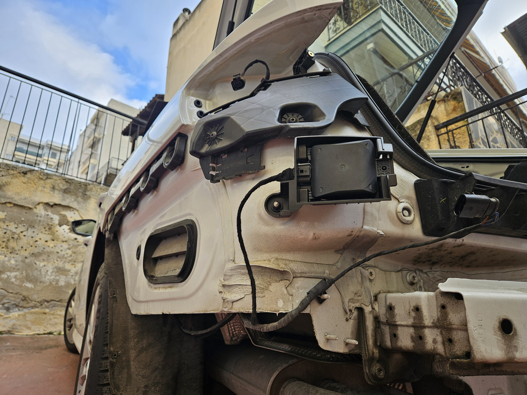

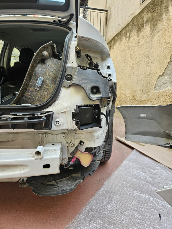

Next step is the physical installation   of the radars (need to remove the rear bumper).
Those are the original places of the radars

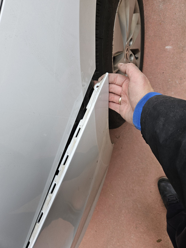

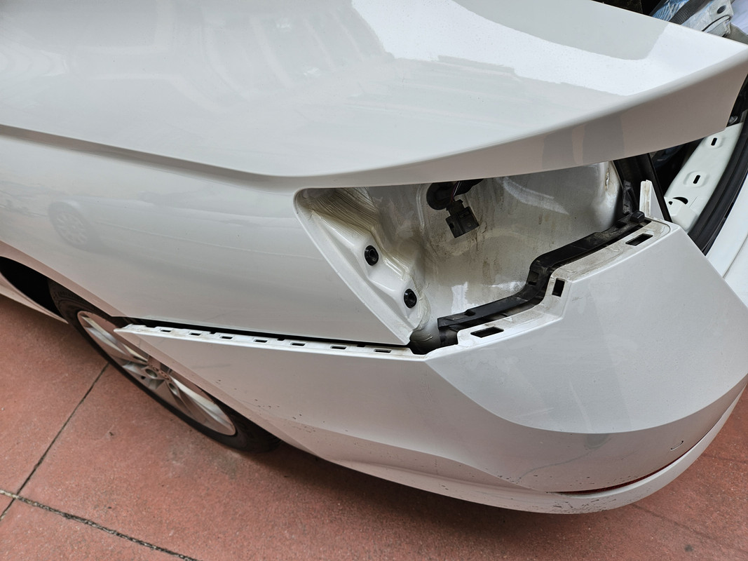

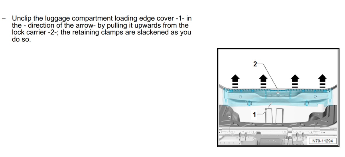

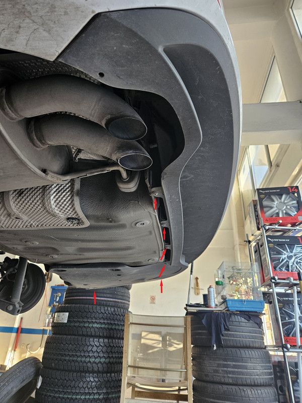

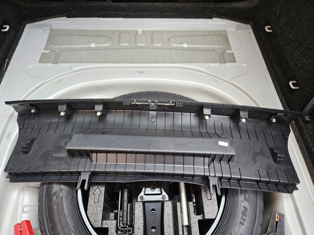

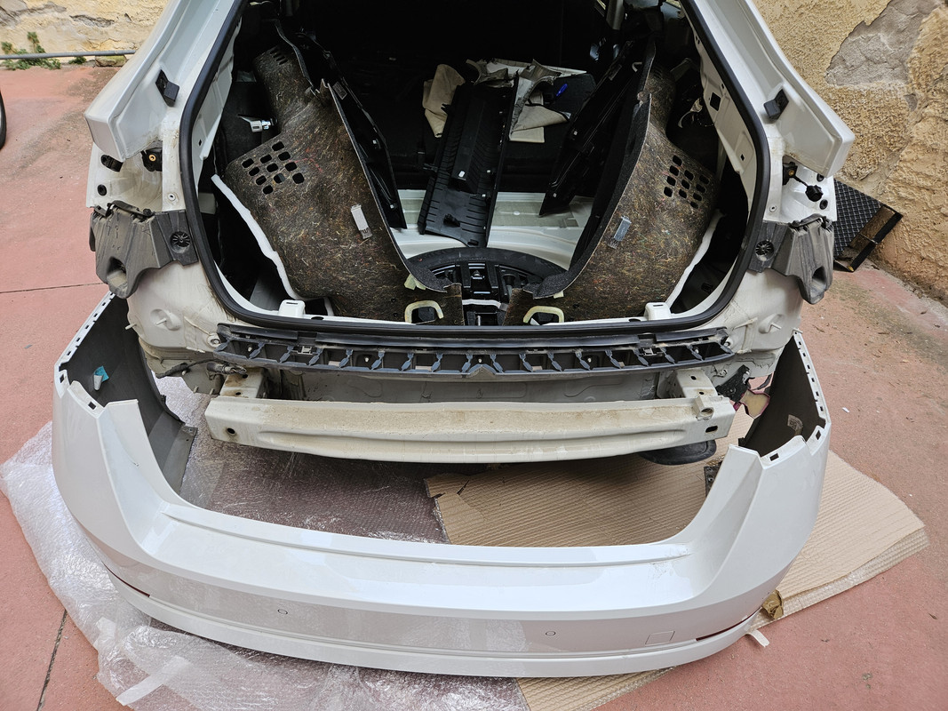

So, the first step for the installation, is to remove the rear bumper.
To achieve this, one must first remove certain other things.
1st the luggage loading edge
2nd the taillights. It is not mandatory, but I recommend it so that the bumper can be easily removed from its clips and no damage is done.

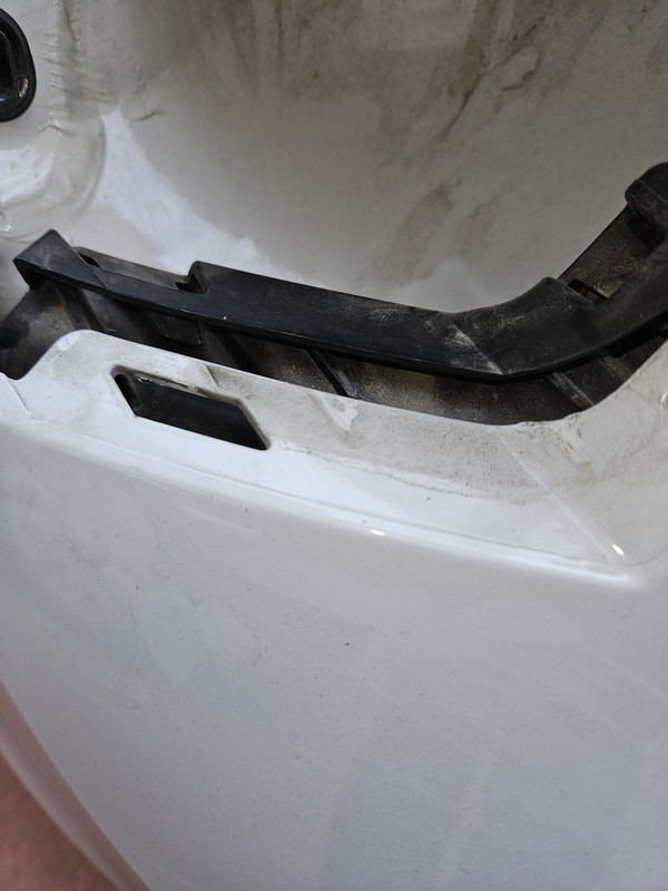

Now we are ready to remove the bumper.
Pull the bumper outwards, disconnect the cable (if any) of the reversing sensors. I suggest putting a protective cloth, plastic or something else on the floor, so as not to scratch the paint.
Done!!!

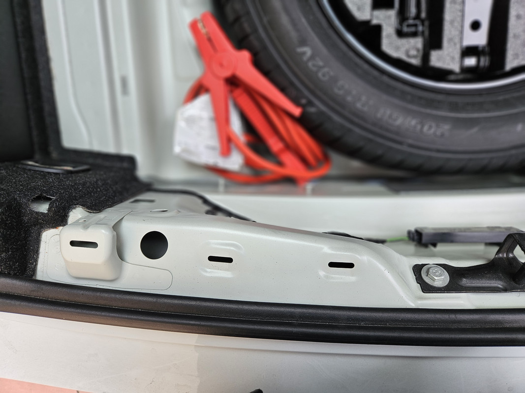

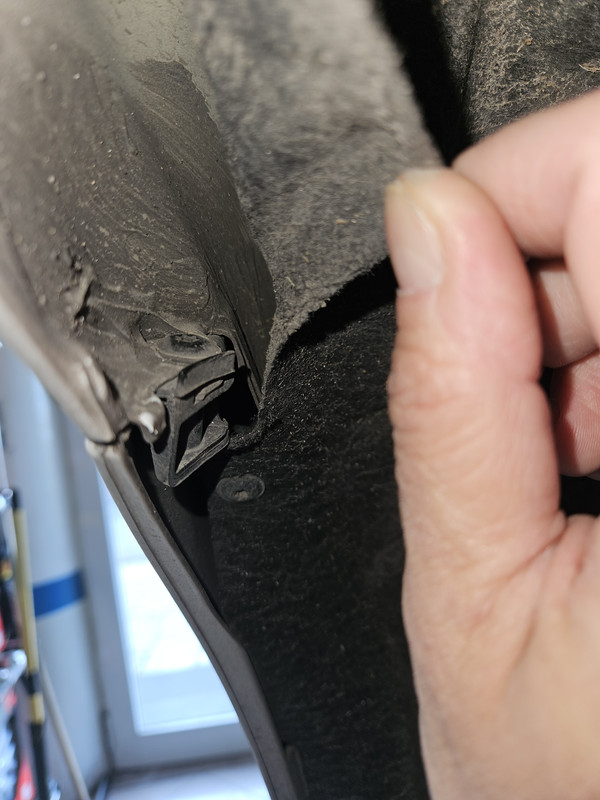

(Note, in this photo it appears that the luggage side trims of the trunk have also been removed.
This is necessary to do so that the wiring to the radar can pass through, I will show it in a next post)

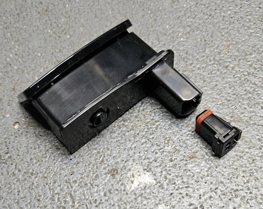

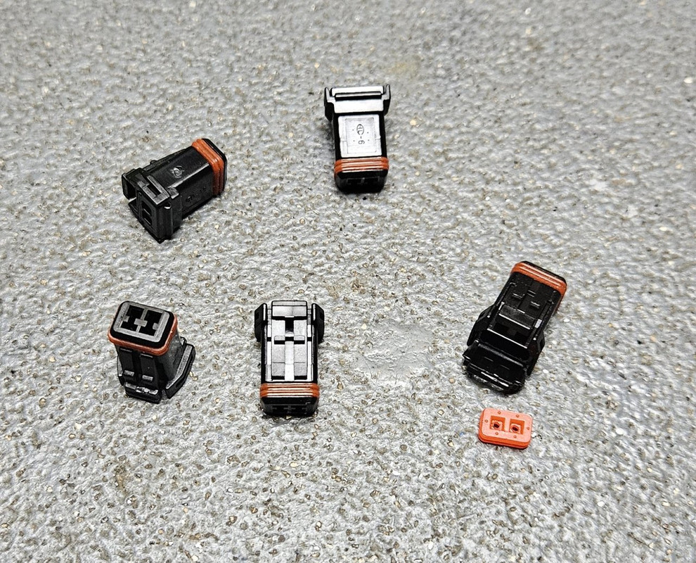

Hello @Giannis20,
Can you give more details about the rubber waterproof  covers for the electrical connectors, please?
I've took a look on AliExpress, plenty of them, I don't know which one to choose: 3P, 4P or 5P.
Any advices are highly appreciated!
Good luck with the retrofit!
Cheers.
Edited by djmartzian
Hi,
it's the 2P

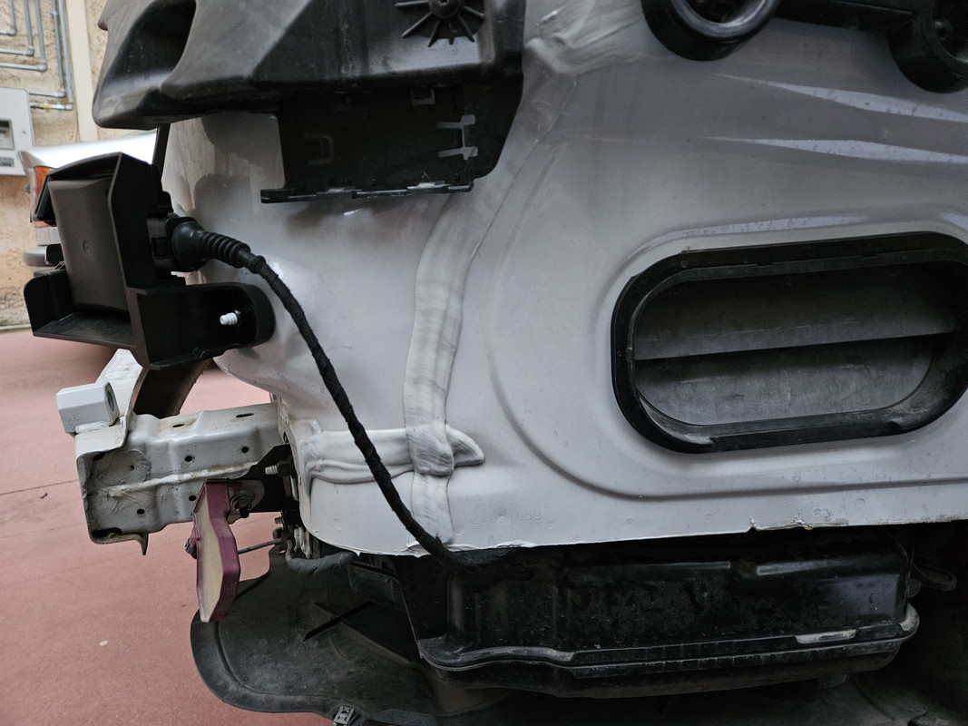

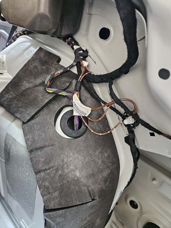

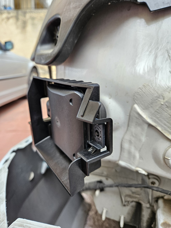

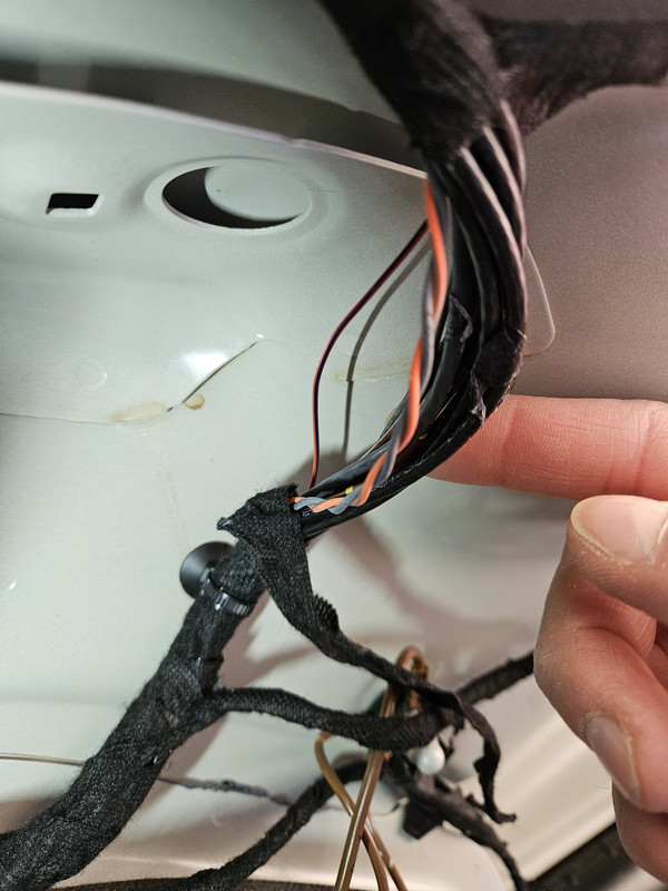

After removing the bumper and the interior lining of the trunk, it's time to install the radars.

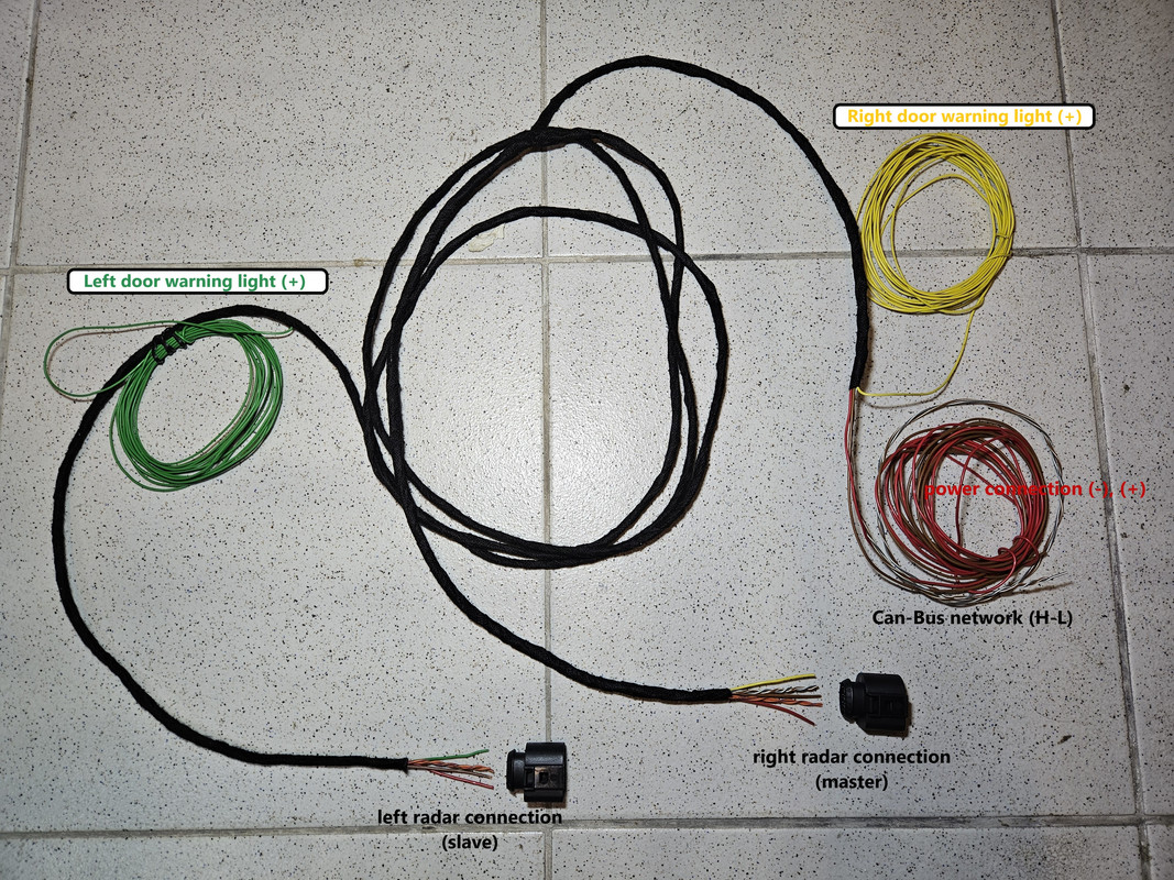

Now it's time for the fun part, the wiring.

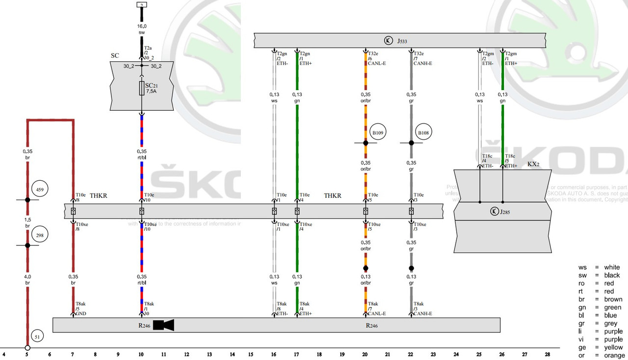

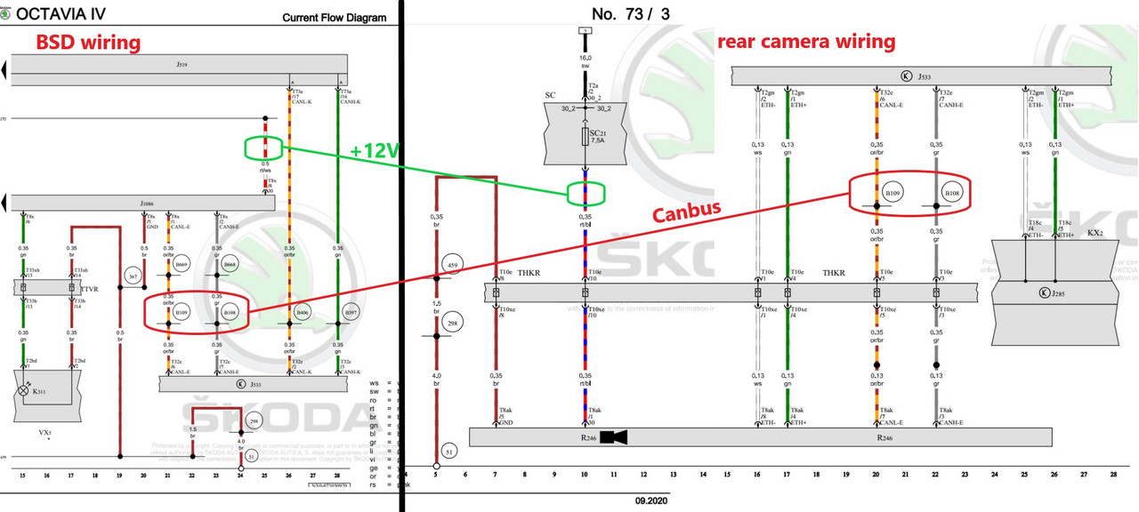

the schematic

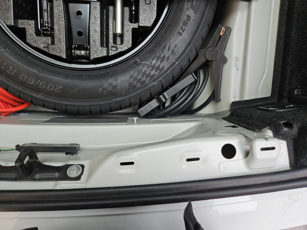

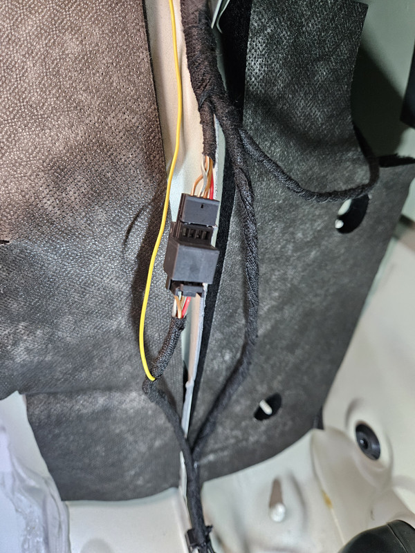

I read that someone use the rear camera wiring to connect the BSD radars with power and Canbus net.
this is the schematic of the rear camera wiring.

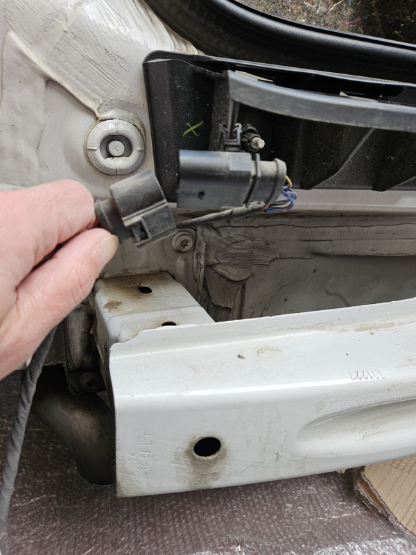

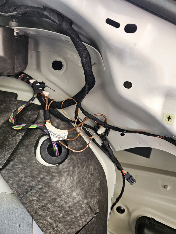

The place of the rear camera wiring is very convenient, is at the right side of the trunk, and has an easy access. it is behind the luggage compartment side trim.
I decided to use the same idea.

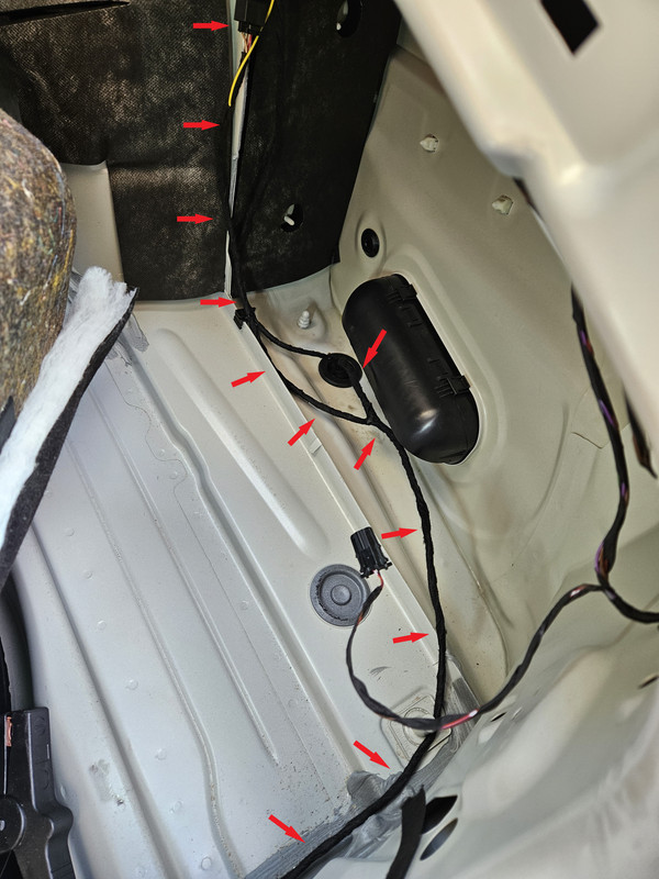

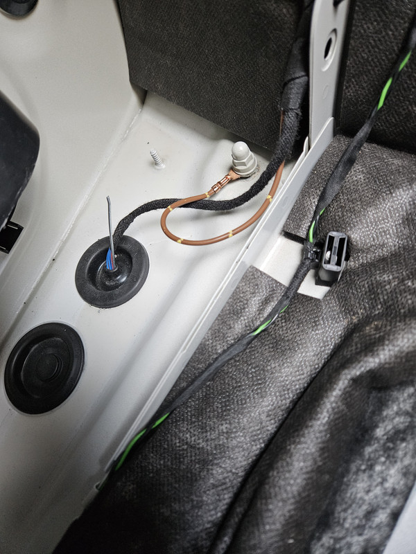

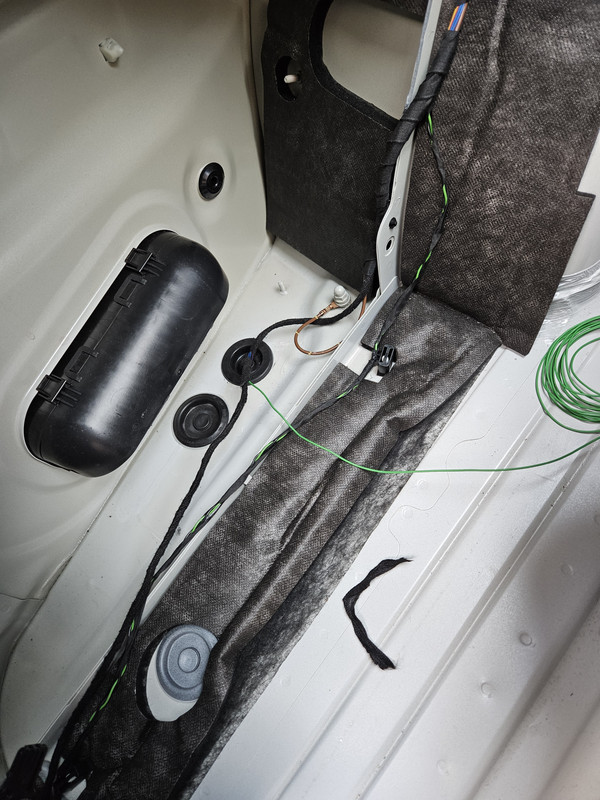

I also decided to use a 4pin connector for my convenience. This is the result.
I root the wires thought the rubber gromets at both sides of the car.
img%5D
And inside the trunk.
Connected my 4pin connector.
img%5D
Done!!!

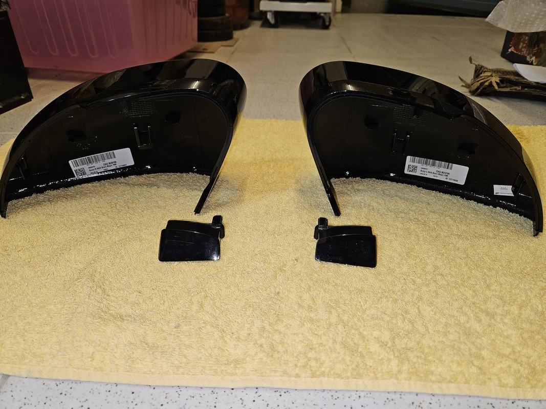

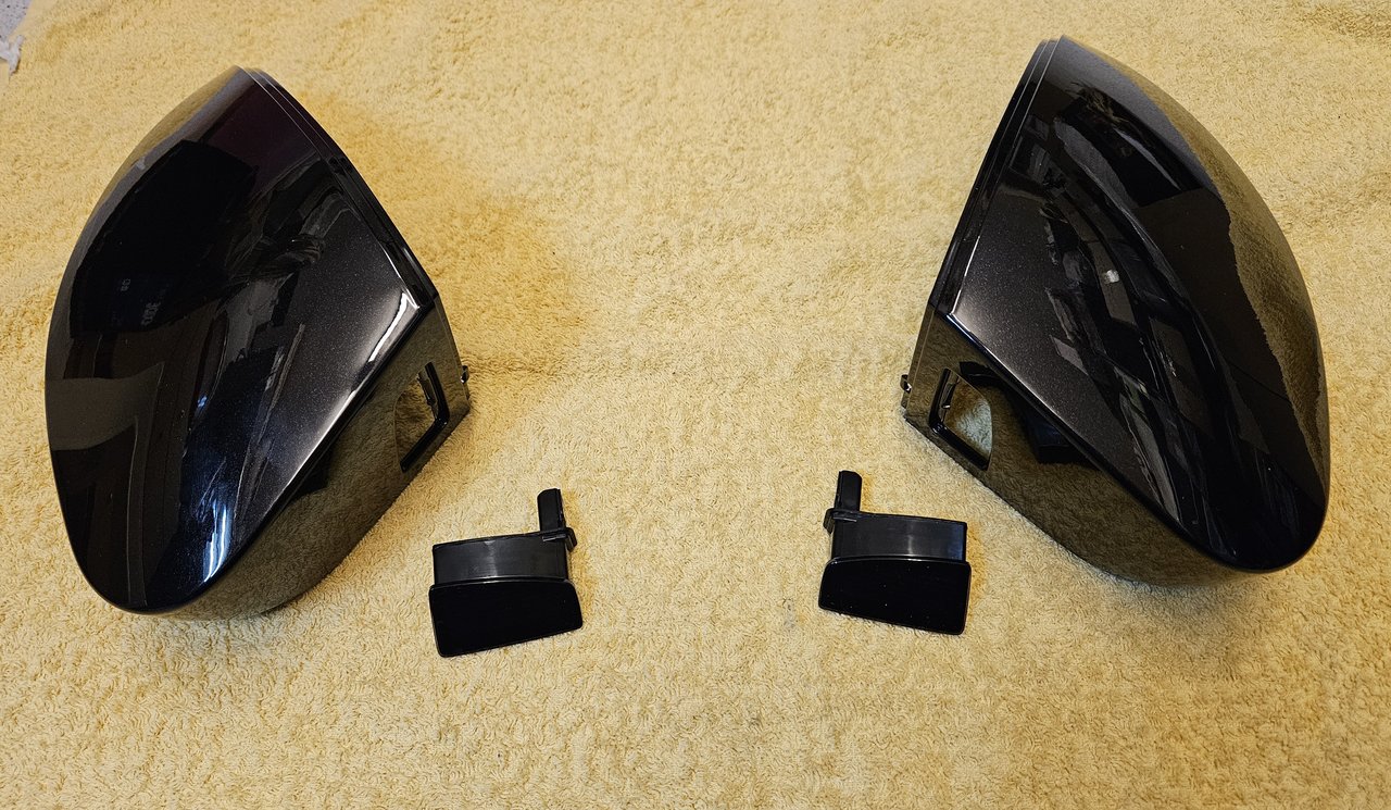

The only thing left is to root the wires (green and yellow) to the front doors for the notification indicator.

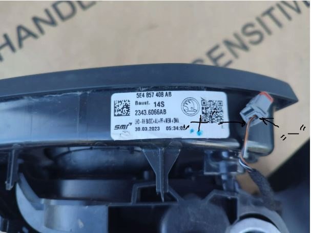

Hello @East_Yorkshire_Retrofits ,
I might need some advised from someone with real expertise on this kind of retrofit.
I managed to route the cables through the mirror lamps, but I'm afraid I can't find verified information related to harness connection, especially to T2b pins?
1. Which is "+" signal and which one is "-" ground? Do you have any pictures with the pin numbers?
2. Is the harness connection the same for right and left mirror lamps?
Really appreciate your support.
Br,
D.
  • Sponsor
It’ll only work one way, and won’t damage anything connected the other way. Both left and right are the same
Thank you @East_Yorkshire_Retrofits for your quick reply.
Are the lamps 5V or 12V ?
I would like to try them on bench and prepare the harness before fitting them on the mirrors/ car.
All the best.
Hi all,
The answer to the above question related to polarity of the harness connection from the mirrors lamps.
Cheers.
