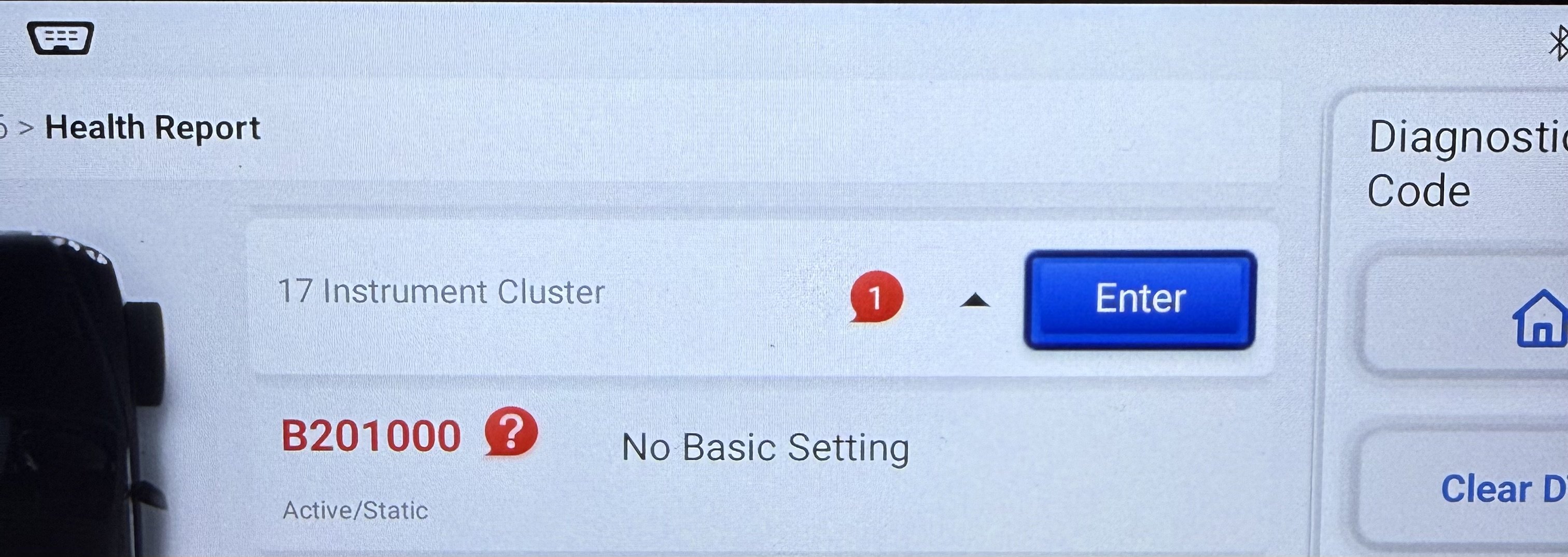

  12. Can anyone help me with this. Did a scan on my topdon and got this code back. All I can find is about a night vision camera? My car is a 2018 1.6tdi sel trim. No error on the dash or anything.
  13. Just follow up to my own post. Found my version. Is MST2_EU_SK_ZR_P0472T I think from looking at mib helper I can update to P0480T Is this relatively safe to do? Seen a few posts that say a fault code sits on the system for the infotainment and might need vcds or similar to fix?
