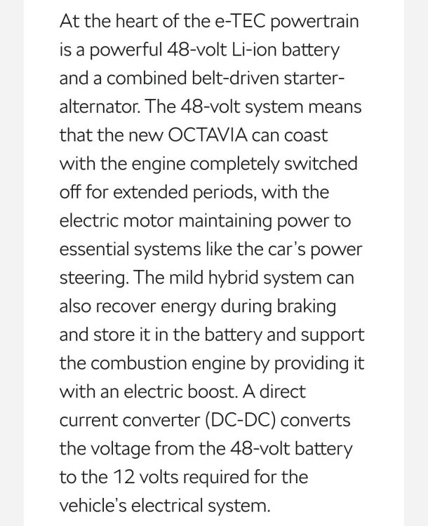

I also recently took ownership of a 2021 Octavia Estate 1.5 TSi manual and noticed none of the driveability issues (ease of stalling) evident with my 2023 manual 1.5 TSi Karoq.
The ride is also considerably more comfortable on the Octavia, which I suspect is probably as a consequence of the 16" alloys and 60 section tyres, as compared to the (relatively) low profile and in my view over-sized 18" items on the Karoq.
