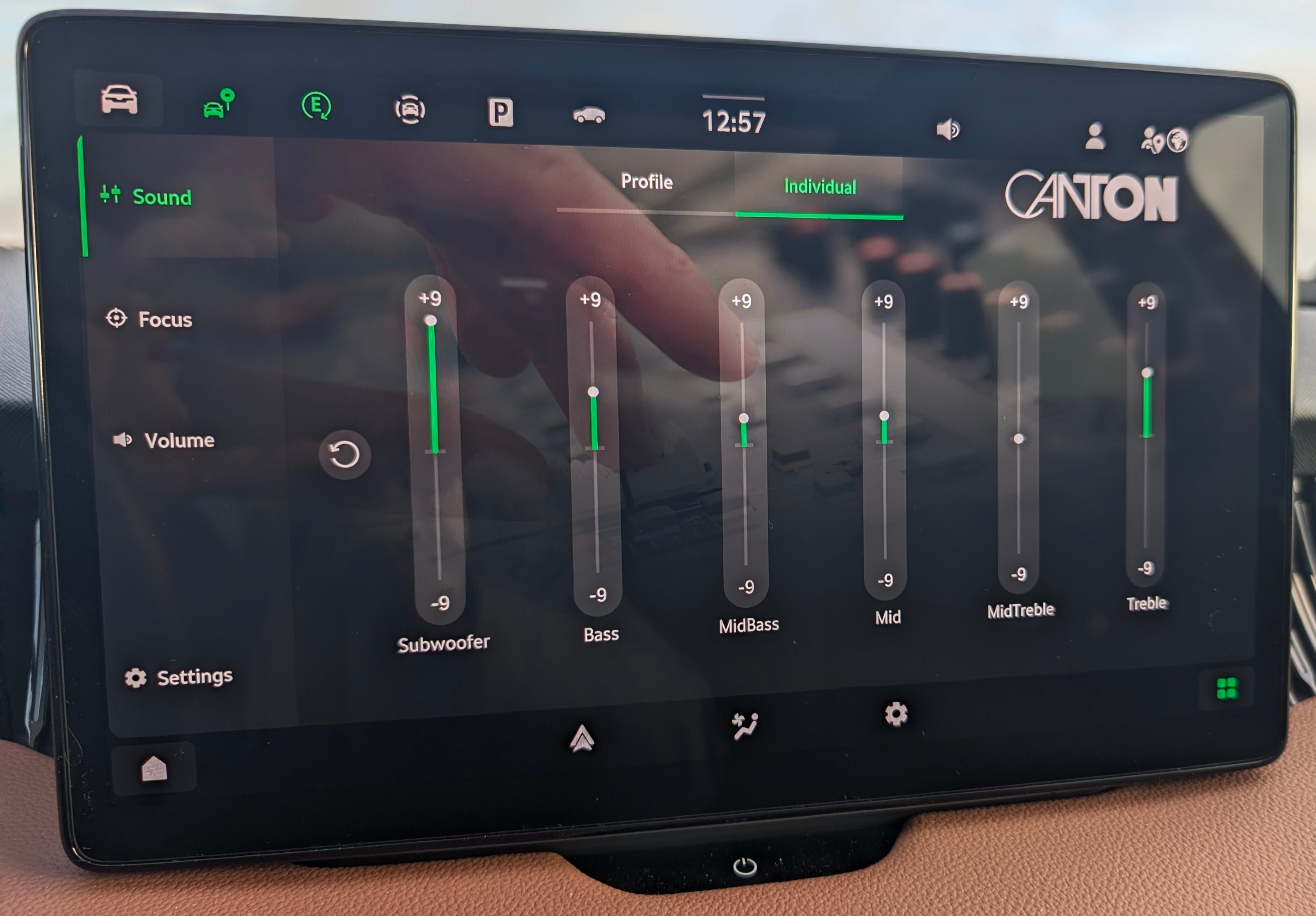

  8. It is the PHEV. I haven't heard that the sub is different. I haven't heard the Canon system in a non-PHEV car to test it. I'm curious to hear what your experience is with these settings
  9. The default settings are awful and the presets are useless. I am not an audiophile, but I have high quality headphones and speakers and am coming from a Volvo V60 with the Harman/Kardon system so I have an idea of what sounds good. In that car, I followed a guide from someone who is an audiophile and kind of adapted the settings to this Canton system. The settings available here are nearly identical to the ones in the Volvo and with a similar set up it sounds way better than default. I set the sub to max. Without setting it to max or close to it, the subwoofer has no effect just like the Harman/Kardon. I've set surround to max after listening at different levels and trying it off. I've also adjusted balance to be slightly forward, while leaving the focus on all seats. This is very subjective, I am by no means saying these are the absolute best settings, but feel free to try it out and tweak to your liking.
