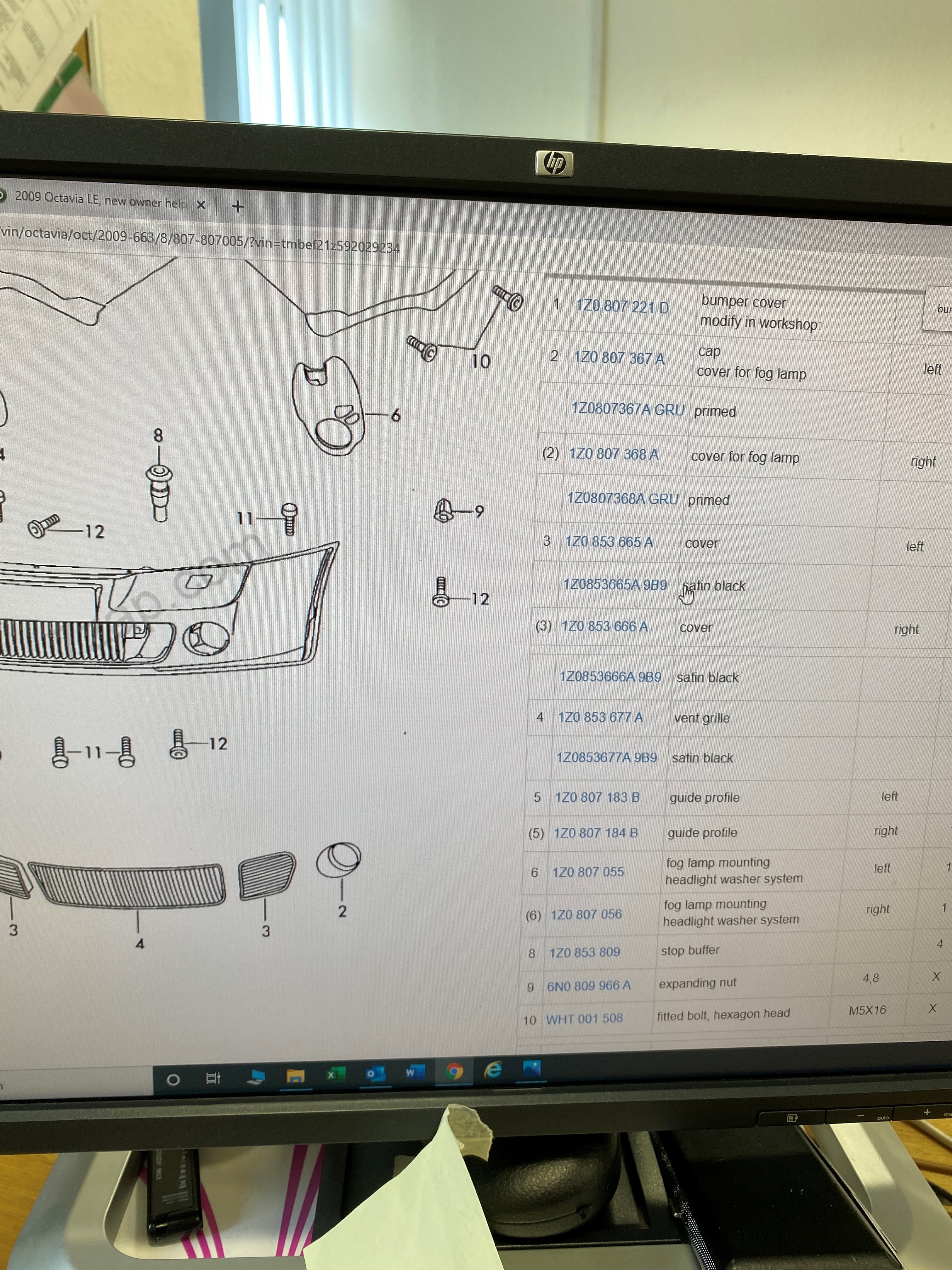

2009 Octavia LE, new owner help
brown_d9 replied to andymc1973's topic in Skoda Octavia Mk II (2004 - 2013)
Hey, see attached looks like item 3 is what you need PN 1Z0853665A. (Mine is also a 2009 petrol VRS Ltd Edition) -
