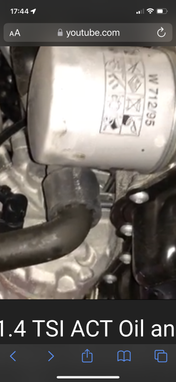

The act engines filter is on the front of the block which you access from the underside, (steel canister type), Skoda has the 2.0 tsi engines (Octavia and superb etc) filter is on the top which is a paper element type, so the original question was regarding a 1.4 act engine which would need doing from underneath, incidentally I do work at a main dealer and we don’t use extraction systems as we go underneath every car to do a health check so it’s a waste of time not doing it by draining it properly and also changing the filter whilst your there- DIY oil change advice
