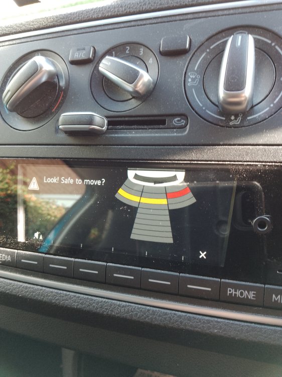

  11. OPS error disappeared overnight and if you take out of gear it clears the screen after a few seconds so all good now This is what its like
  12. I'm not sure....but the OPS issue seems to have resolved itself overnight! I think I tried a reset of info system but on stop/start from key since today no more alerts - seems all good. Thank you

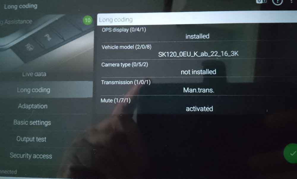

  13. Hi, This is a coding issue for sure but struggling to know the correct coding, wonder if anyone had similar. Put something in initially via ODB11 I bought a few years ago but some of the coding is a bit gray so got some VCDS help.... Seems like with the below added to 5F - it does finally show the parking as I've seen correctly on other units! Beeps and all. Its just an initial message Optical Parking System (OPS) currently not available or similar, you press ok and it just comes up with parking lines anyway and they work - show proximity to objects. So 99% there but would be nice if I knew which bit was the answer to 100% success removing that error? Pretty sure sensors and all work because it was beeping before attempting to resolve the visual stuff plus have seen logging and its showing values on each sensor confirming they work. It also confirms the system picks up reverse gear status etc. From https://forums.ross-tech.com/index.php?threads/32203/ (For 5F coding):- "VW Up 2012 - RVC and PDC retrofit - nothing on the display Adaptions are not good I think: ENG122227-ENG117496-Car_Function_Adaptations_Gen2-menu_display_pdc,activated ,60 ENG122227-ENG117500-Car_Function_Adaptations_Gen2-menu_display_pdc_after_disclaimer,activated ,60 - set to NOT activated ENG122227-ENG117497-Car_Function_Adaptations_Gen2-menu_display_pdc_clamp_15_off,activated ,60 - set to NOT activated ENG122227-ENG117498-Car_Function_Adaptations_Gen2-menu_display_pdc_over_threshold_high,activated ,60 ENG122227-ENG117499-Car_Function_Adaptations_Gen2-menu_display_pdc_standstill,activated ,60 - set to NOT activated ENG122229-ENG117710-Car_Function_List_BAP_Gen2-parking_assist_0x0A,not activated ,64 - set to ACTIVATED ENG122229-ENG117711-Car_Function_List_BAP_Gen2-parking_assist_0x0A_msg_bus,not activated ,64 - set Terminal 15 Test reset radio and let us know!"
  14. Coding mostly solved, but could do with some small assistance but visual lines also showing. I think from diagnostics and rear parking all the sensors seem to be operating I think. As it was already warning when you are getting close and very close Now found following some adaptions it is come up and working correctly ( sort of)! I now have display lines that work along with the beeps. At some points it says "OPS is not available" I think each time the car stops/ starts - but still carries on and displays parking sensing anyway!?! Also after taking out of reverse it doesn't automatically immediately remove the sensing, I think it does momentarily if you move though so not sure if there is further coding for this. So 90% working with some minor gripes The coding I assumed from "VW Up 2012 - RVC and PDC retrofit - nothing on the display Adaptions are not good I think: ENG122227-ENG117496-Car_Function_Adaptations_Gen2-menu_display_pdc,activated ,60 ENG122227-ENG117500-Car_Function_Adaptations_Gen2-menu_display_pdc_after_disclaimer,activated ,60 - set to NOT activated ENG122227-ENG117497-Car_Function_Adaptations_Gen2-menu_display_pdc_clamp_15_off,activated ,60 - set to NOT activated ENG122227-ENG117498-Car_Function_Adaptations_Gen2-menu_display_pdc_over_threshold_high,activated ,60 ENG122227-ENG117499-Car_Function_Adaptations_Gen2-menu_display_pdc_standstill,activated ,60 - set to NOT activated ENG122229-ENG117710-Car_Function_List_BAP_Gen2-parking_assist_0x0A,not activated ,64 - set to ACTIVATED ENG122229-ENG117711-Car_Function_List_BAP_Gen2-parking_assist_0x0A_msg_bus,not activated ,64 - set Terminal 15 Test reset radio and let us know! " The ones I turned on were menu_display_pdc ( did this before but didnt get anything), plus the threshold one, and the 0x0A were ones I didn't apply or couldn't apply for some reason before but now activated. May need some more experimentation depending on how much it annoys my wife.
  15. It was...but may be missing something Now found following some adaptions it is come up and working correctly ( sort of)! I now have display lines that work along with the beeps. At some points it says "OPS is not available" I think each time the car stops/ starts - but still carries on and displays parking sensing anyway!?! Also after taking out of reverse it doesn't automatically immediately remove the sensing, I think it does momentarily if you move though so not sure if there is further coding for this. So 90% working with some minor gripages

  19. I think it may be 5F missing coding but may need to look more into this...
