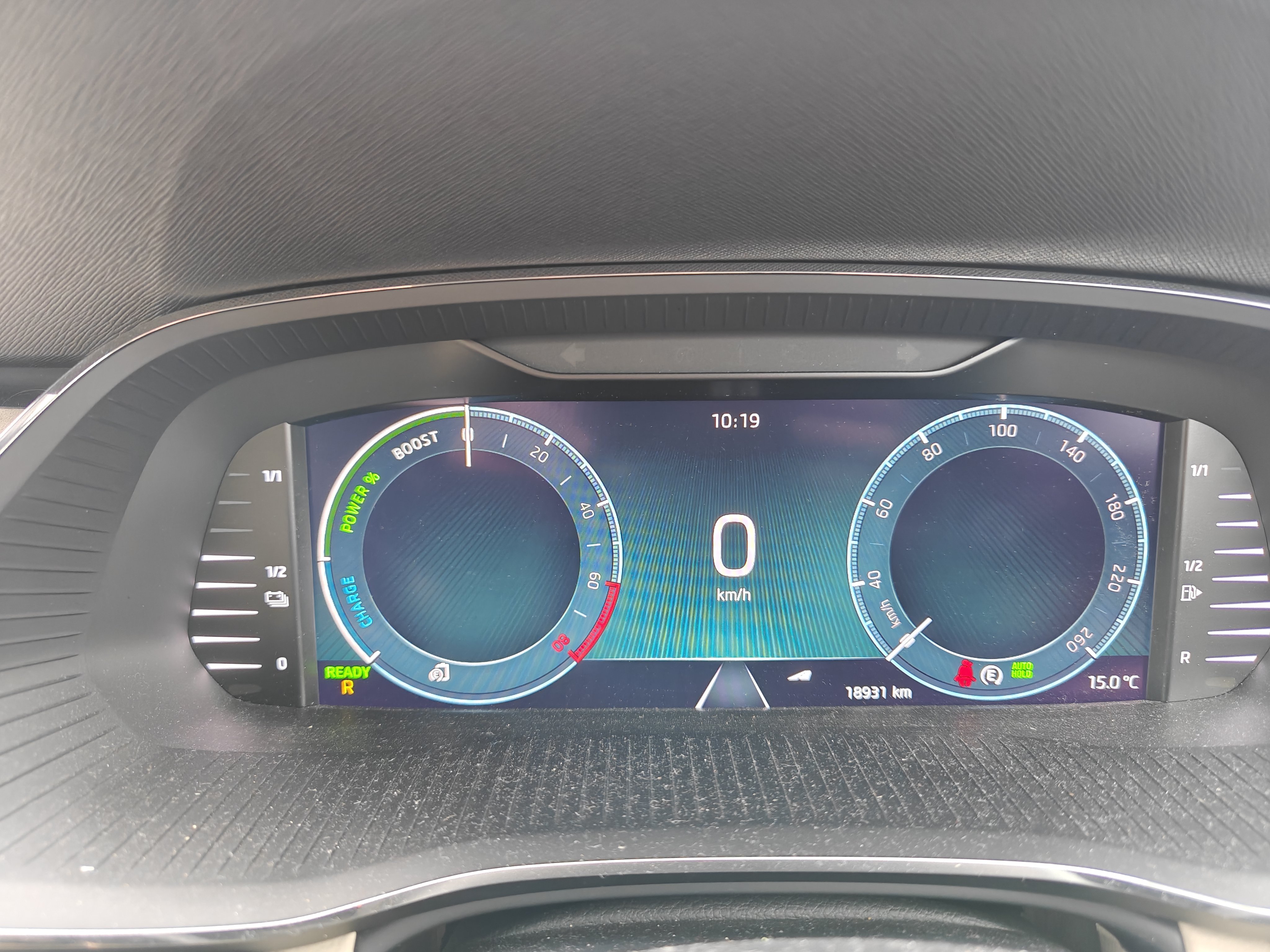

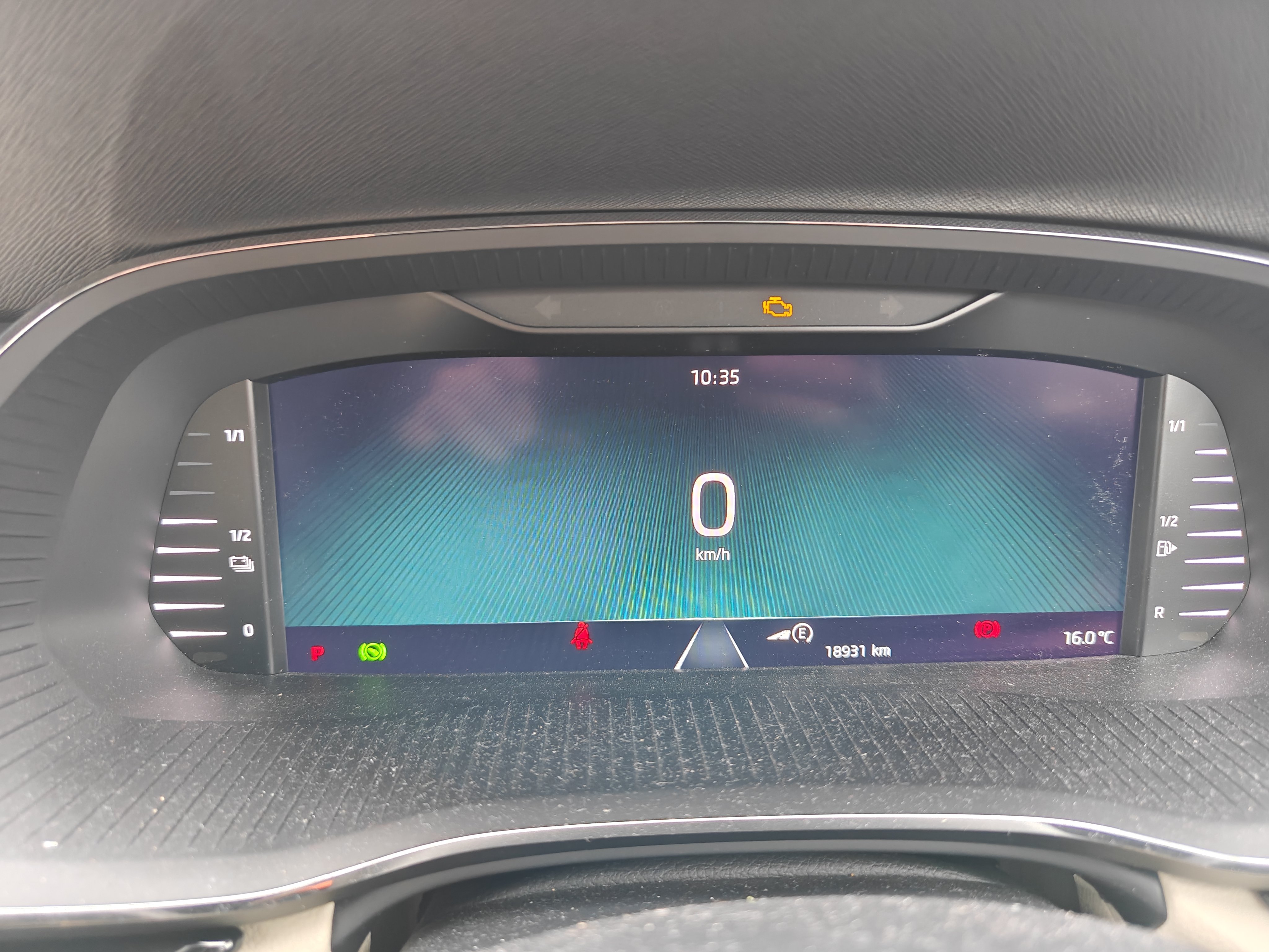

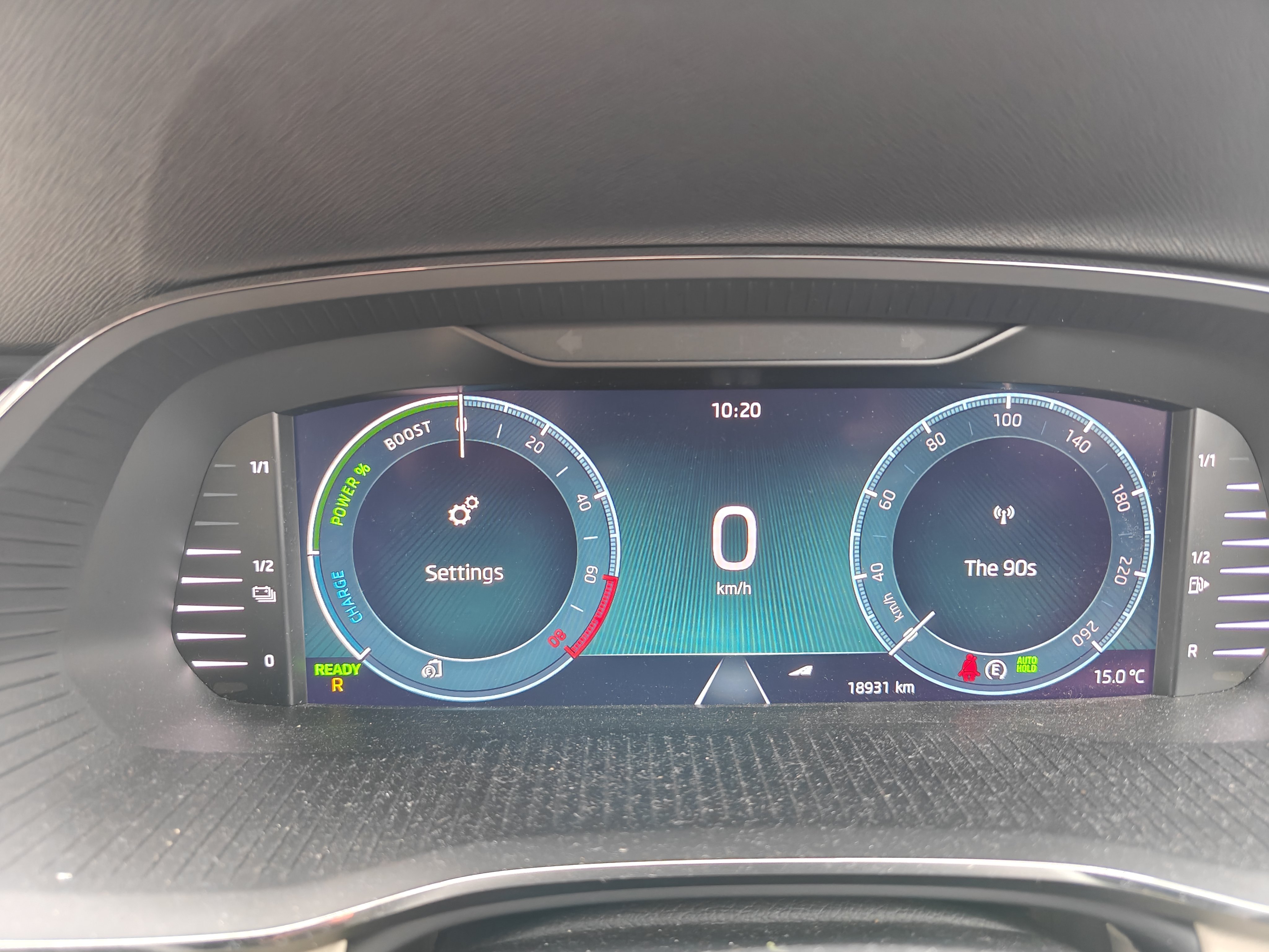

  6. Hi, can you give more detail on this, does it mean that you can't force it into hybrid manually upon start up and it uses all available battery automatically prior to using the ICE, or something different? Edit, nevermind, I see the thread about it.

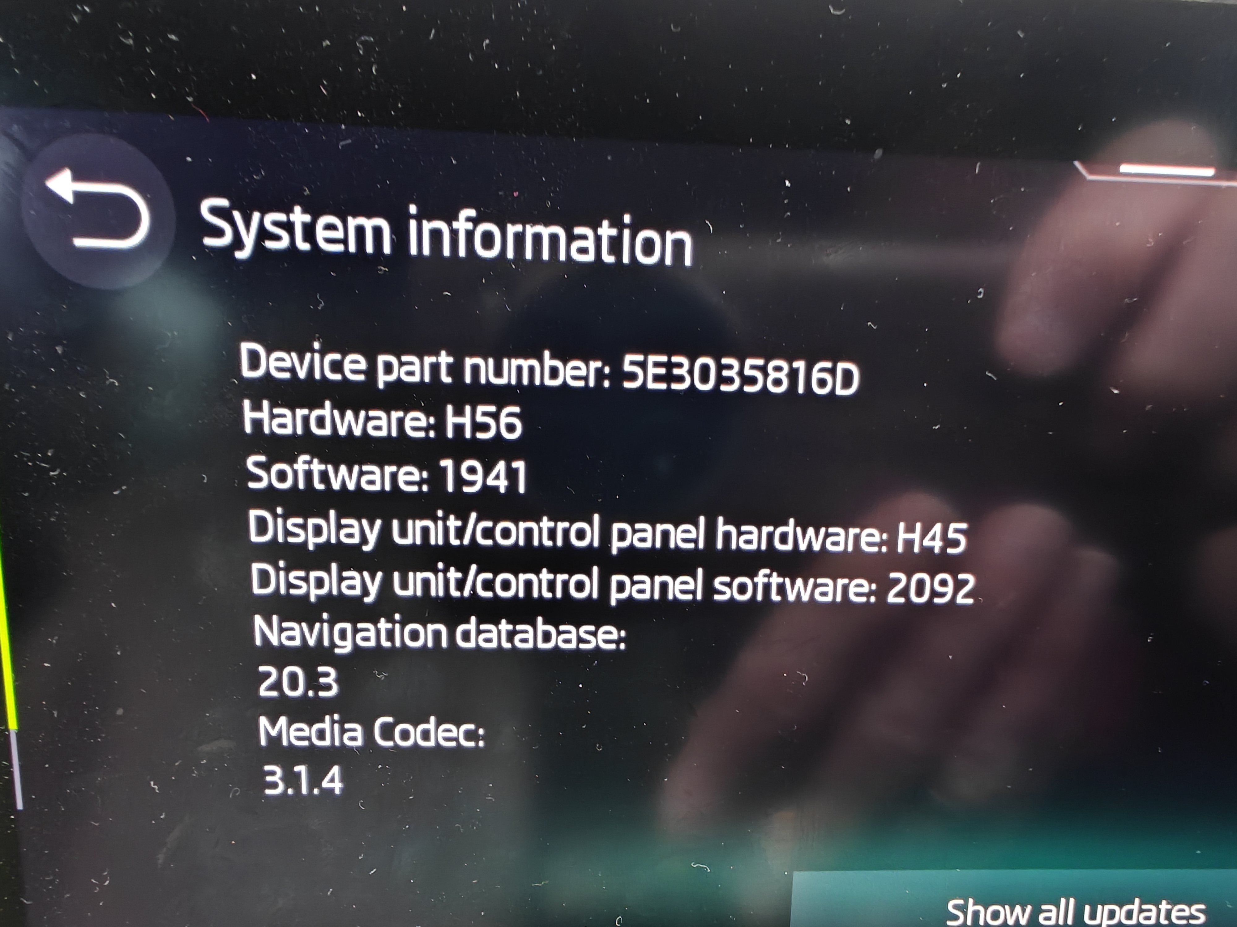

  10. So was changing one of the displays on the virtual dash yesterday so see the average consumption and then it just went blank. It's now stuck on settings and the radio displays, see first pic. (2021 car running on version 1941, pic attached with all details) If I hold the button on the steering wheel to try changing things it just goes blank, see the second pic. On the other dash displays it's the same thing, blank, and on the map one I get full screen maps. I thought it may sort itself out over night but it's still like this this morning. Anyone have any ideas or see this before? I've thought about restoring factory settings in the infotainment unit but does that only effect the head unit itself and not the virtual dash?

  14. So this morning I surprisingly got a message telling me there's an update available, it was OAA2 so only about 190Mb, and that had rolled out a long time ago anyway. I had read somewhere that the above hardware/software combination couldn't receive OTA so when I saw the update roll in I was thinking I may even be able to cancel the dealer appointment (who quite possibly wouldn't update anyway). When I went back to the car later I got the message saying the update was competed, but all the software versions remain as they were in the screenshot above from a few weeks ago. Should the update have moved things on even a little, or is it prep for another bigger update?
