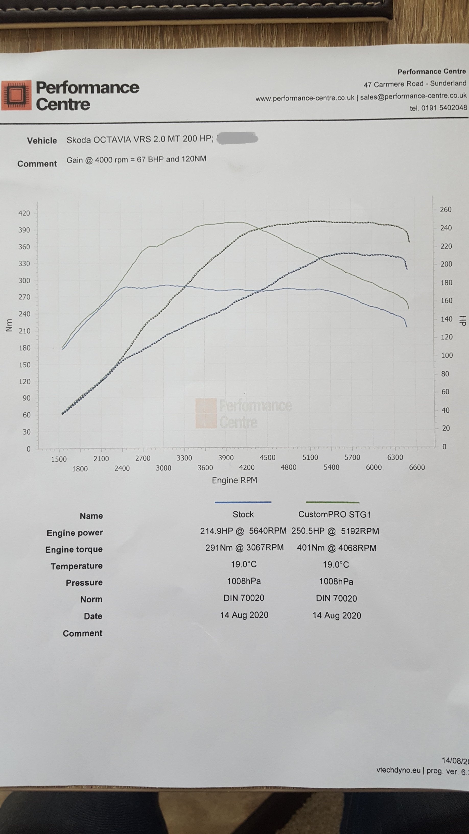

  5. Mine's got 400nm torque, goes well for something that could be brand new!
