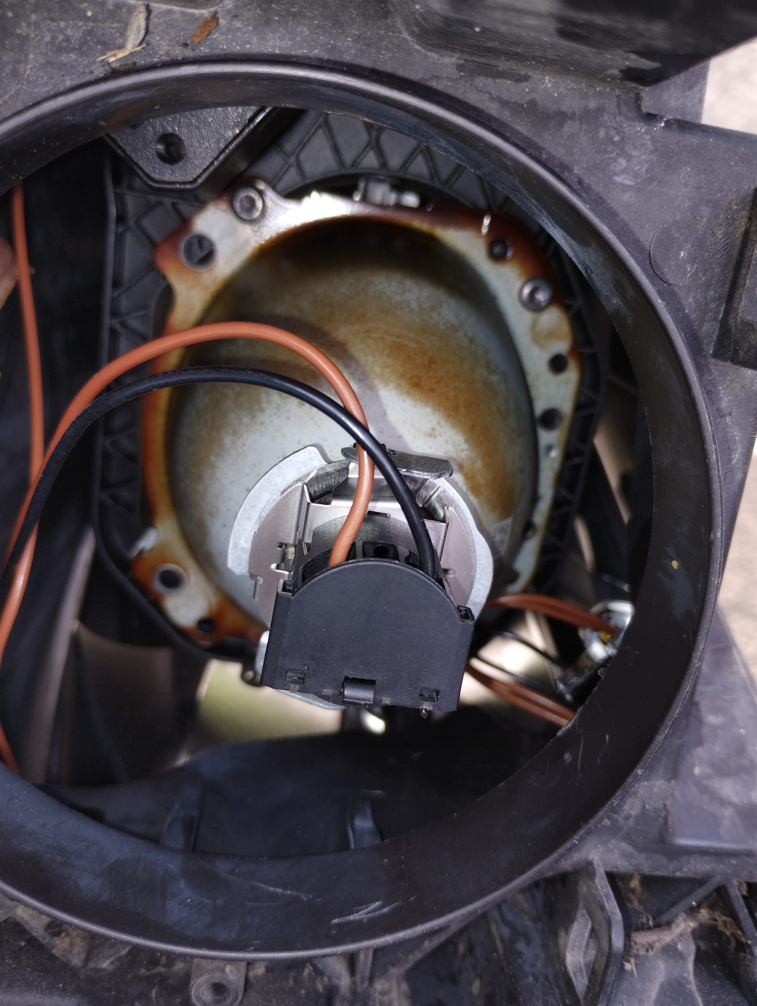

  6. I cant really see much difference with an earth wire attached, however I'm doing it with a bit of wire in daylight. Im wondering are they supposed to look like this inside almost a burnt appearance to my untrained eye. I noticed theres 2 little lugs inside both lights, like you attach spade connectors to, would these be a good place to earth both lights? Thanks for all the replies
