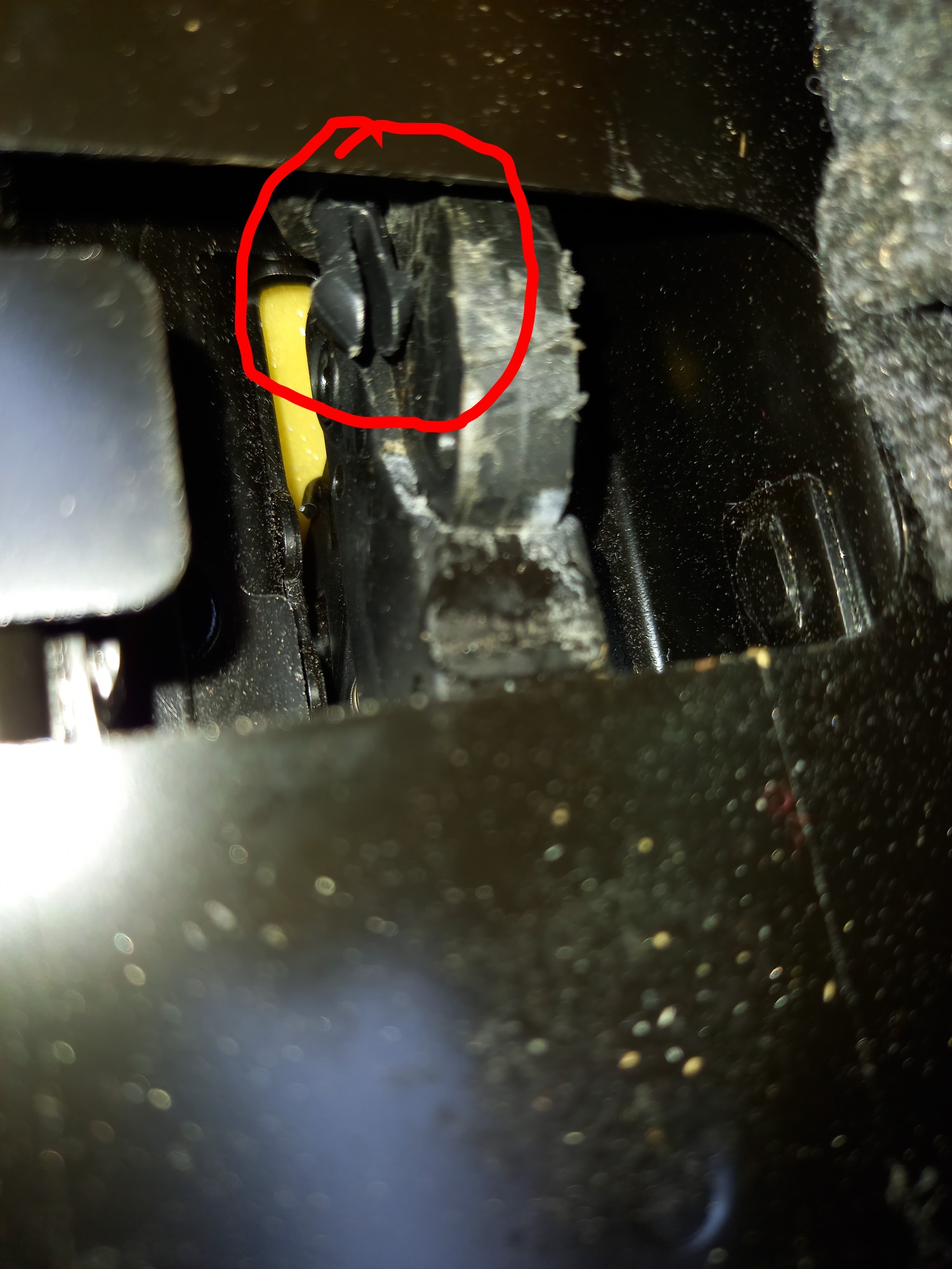

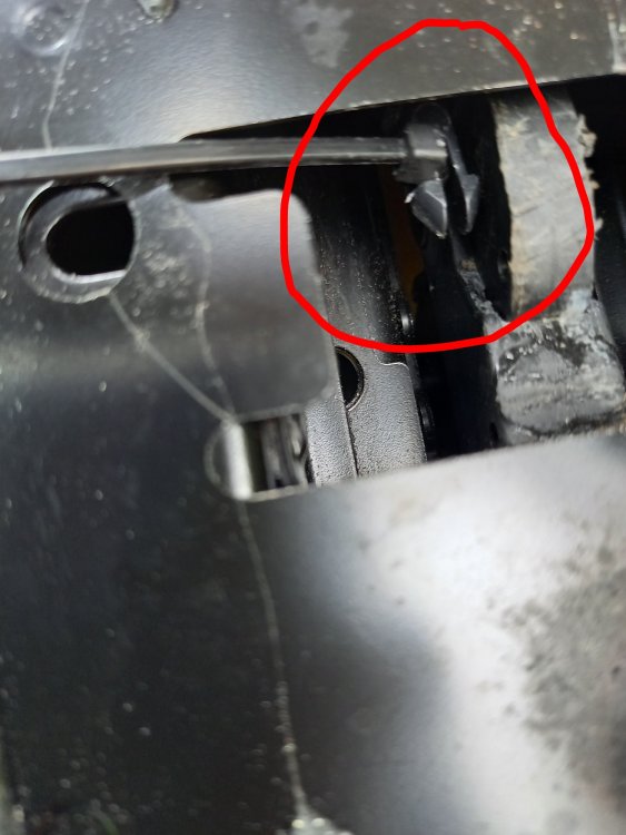

  4. Had the common issue - rear seat pull release becoming detached from the catch. Fortunately had only come out of the hole. Decided to try and prevent it happening again and wrapped a cable tie around one of the prongs ( in retrospect it may be better to put one on each so as to not stress the single prong). Here are before and after photos.
