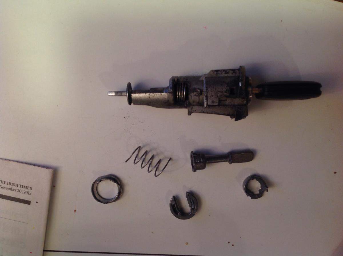

Have an Octavia MKIi and foolishly ordered a repair kit.... Is there any way of opening the cast aluminium casing/housing for repair? Really annoying you can't access the inside, can clearly see the bit that needs to be replaced.post-110974-0-01767100-1385912849_thumb.jpg
