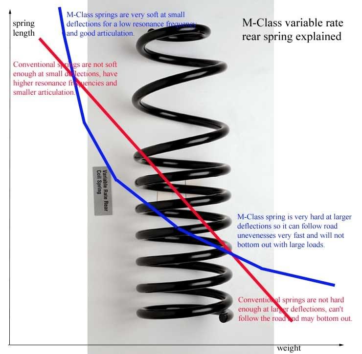

Hi
The majority of the lowering springs these days are progressive springs
There is a little info on progressive springs in the pic
Koni , Eiback , Weitec are all progressive springs
The way that it will help with body roll is all down to the fact that you are lowering to start with
The ARB`s are far better at reducing body roll as that is what they are designed to do
I hope that helps?
Sarah
