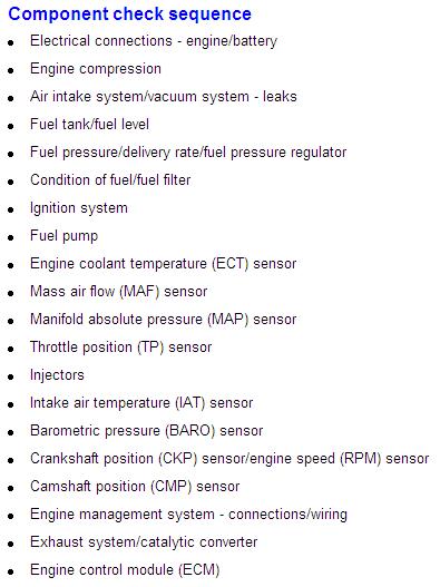

If your rough running just after starting could be classed as 'difficult to start from cold', then the (mis)guided checklist runs something like this:
HTH :thumbup:
