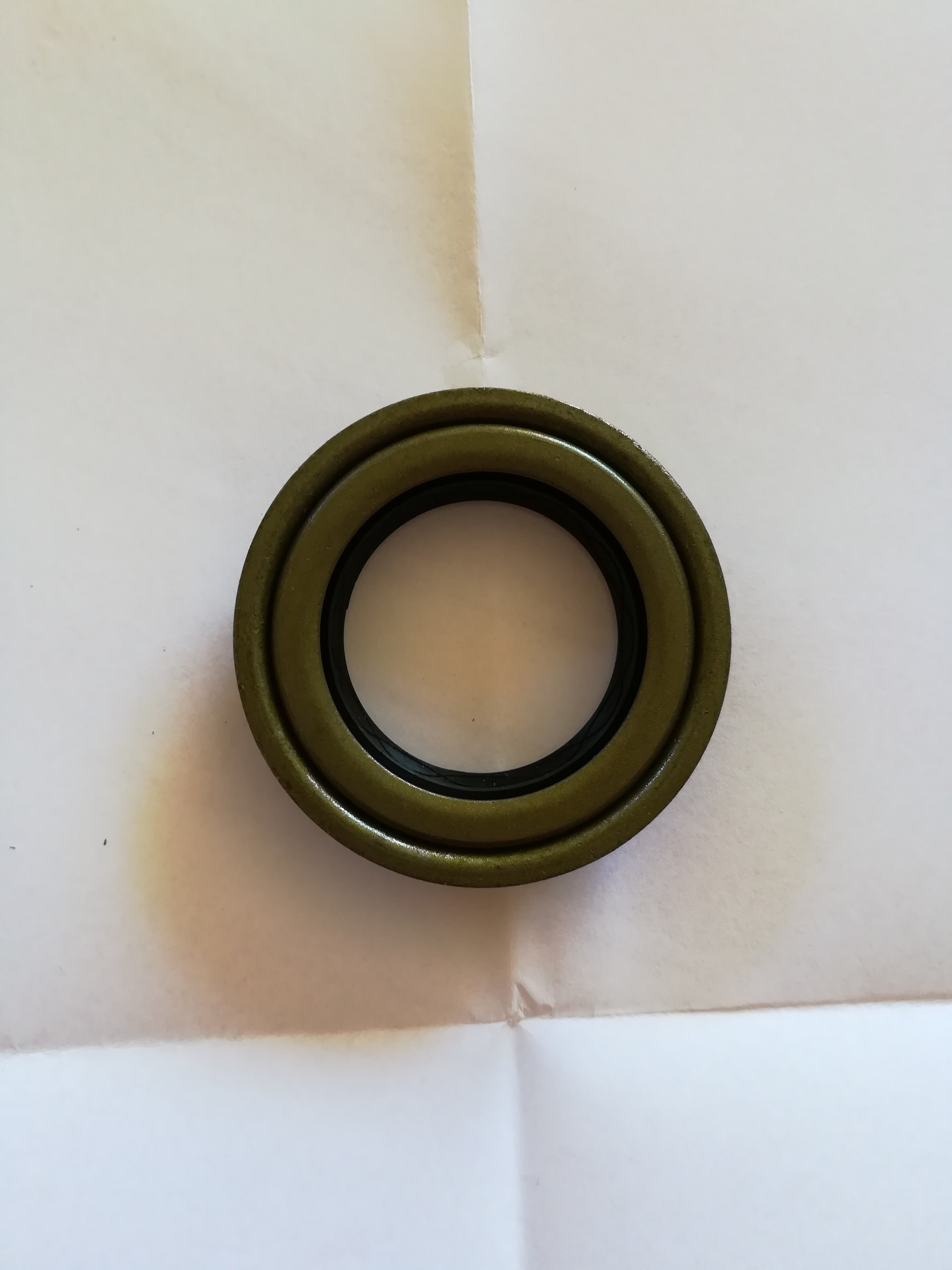

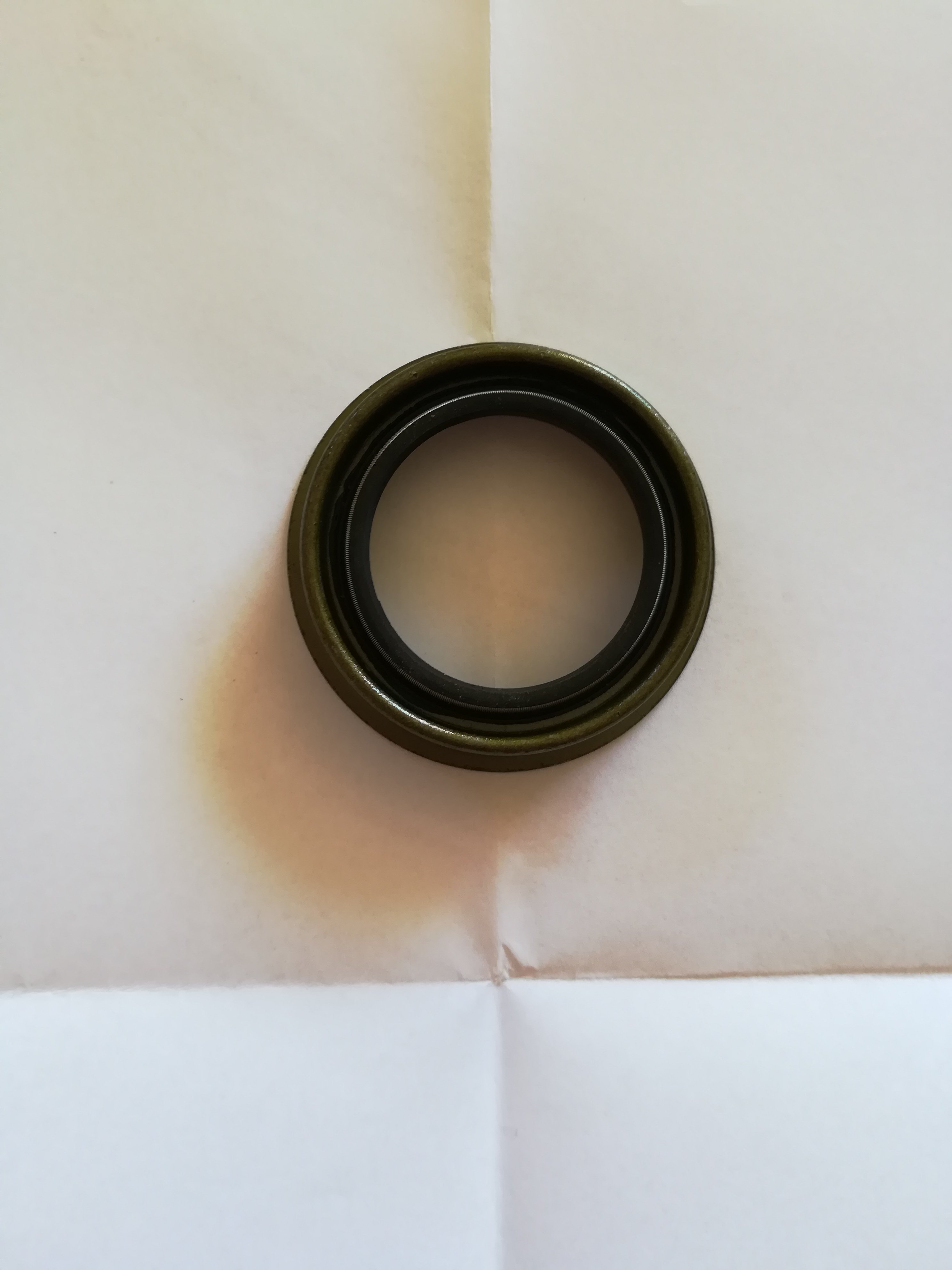

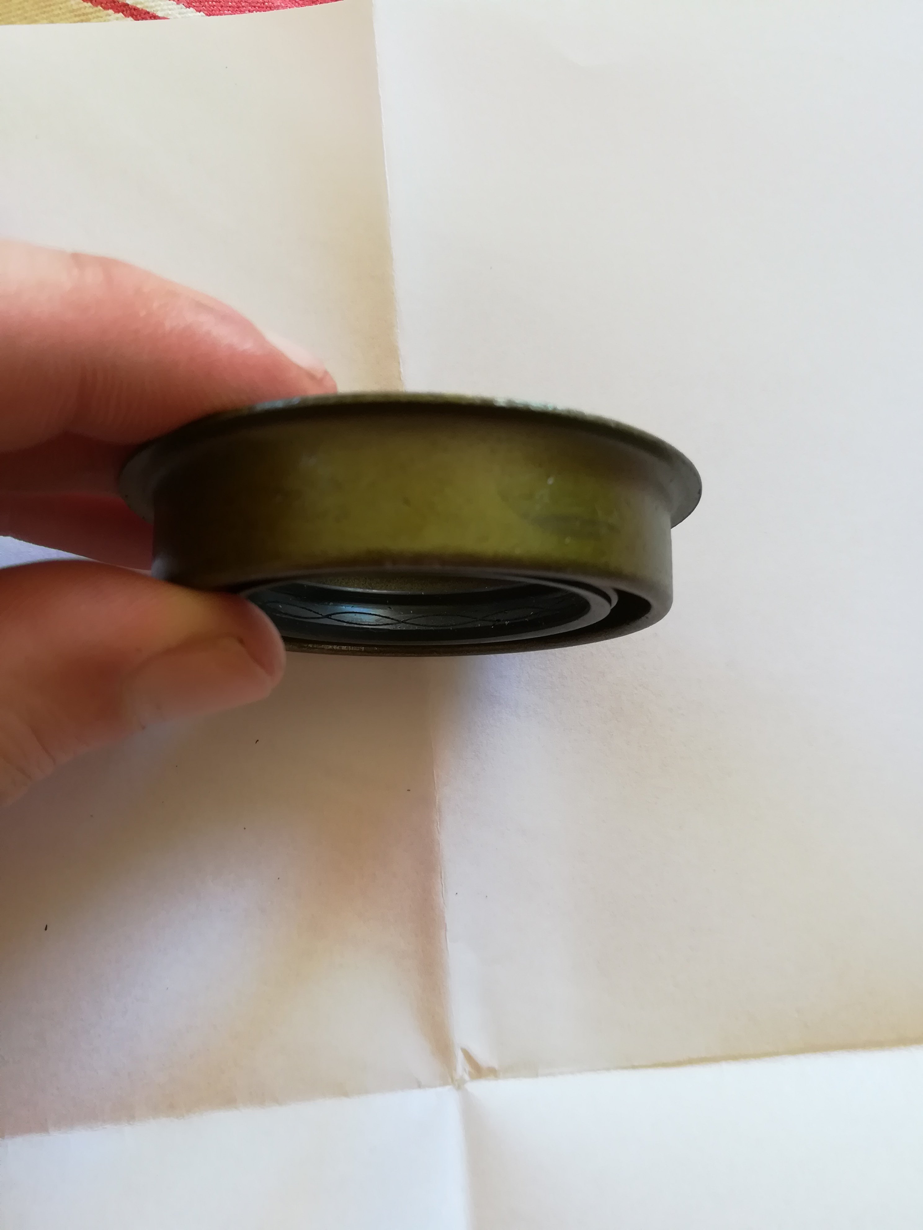

Hi, does ànyone have the part no for the driveshaft géarbox oil seal? Or the name or dimensions. Ive found a differential seal by Corteco 12019597B, 55mm outer diameter, 40mm inner and 8mm high. Without taking it out its difficult to know if it is the right one.
Thanks
