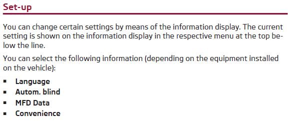

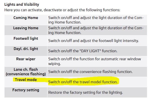

The manual states Select Tourist Light form menu.
On the Menu there is only a Travel Mode that looks as if it may do the trick.

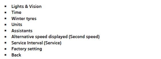

In my Skoda superb 2 the travel light option is Missing how do i take it out
Do you have the factory fitted bi-xenon headlights? 'Travel Mode' only applies to the xenon, not regular halogen headlights...
Edited by silver1011
Yes they are factory fitted
Perhaps the features and specs differ for Superb's that were destined for the Indian market?
If you have factory-fitted bi-xenon's then 'Travel Mode' should be visible in the 'Lights & Visibility' menu.
Till yesterday it was there after the afs stopped working i can't find it and now i receive two error message
1 afs not working owners manual
2 check right dipped light
I checked all my ways bulbs are good fuses are good the thing is right headlight not working and afs stopped working and I can't find travel mode

'Travel Mode' relies on the AFS mechanism to adjust the beams.
If your headlights are faulty it stands to reason that the 'Travel Mode' feature becomes temporarily disabled.
