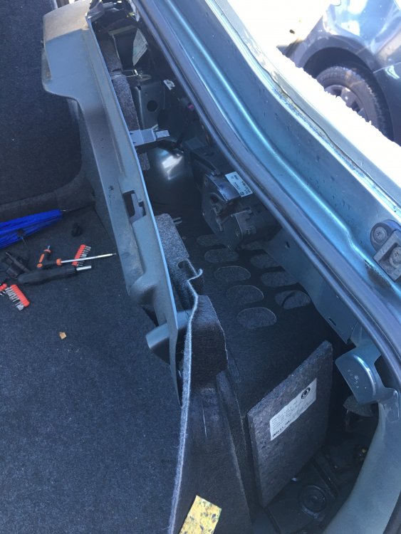

I have replaced fuel flap lock actuator on skoda superb ll 1.9 tdi 2009 . Its easy, no need to fully remove the side trim of the luggage compartment. It doesn't even need to open that much as shown in photo. Slacken it little bit to clip the new connector. See photo to het an idea.
