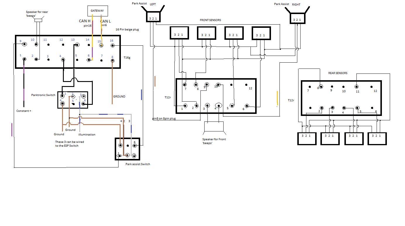

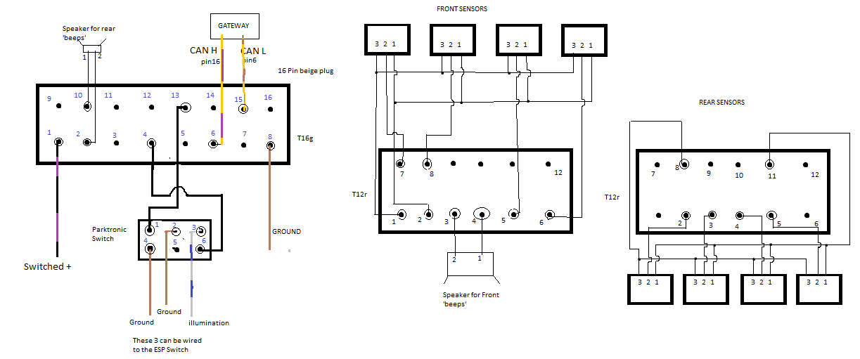

Here is the wiring diagram I made if anyone is interested.
Wiring Diagram for OPS front and rear
Diagram for wiring in Park assist to existing OPS
Diagram for OPS & Park Assist
