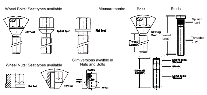

One thing I meant to ask originally was, does anyone know what taper angle the bolts have on a Superb? You need longer bolts and often you need to stipulate the taper angle.

There is usually only Tapered or Rounded bolts and you will only be able to use one or the other, Superb bolts are tapered and as stated always use Hubcentric spacers or you will suffer some 'wheel wobble, I have noticed nothing but an improvement running spacers but then it's difficult to judge when your car is on the floor.......... :giggle:

As for the bolts, I've seen companies offering 40degree tapered bolts and 60degree tapers. Why can I see me later wheel brace in one hand and protractor in the other?

A word of warning, make sure you get the correct bolt lengths and type. The standard Superb bolts have a 25mm thread on them. So if you're going for 15mm spacers you need 40mm threads (25mm+15mm=40mm). Similarly if you're going for 10mm spacers you'd need 35mm threads.
Get the bolts too short and they're unsafe as they don't hold the tyres on well enough. Get them too long and they poke through the hub and your car isn't moving anywhere and damage can ensue.
My advice, remove a single bolt before ordering, measure the thread length (from the base of the collar to the end of the thread) just to double check beforehand.
Also dependent on your alloys you'll have either radius or tapered bolts. Easy to tell which by looking right under the bolt head .... if it's domed it's a radius type, whereas if it looks coned it's a tapered type.
