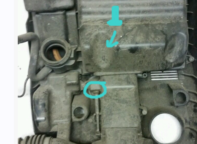

To day I checker set thermostat on the air cleaner, and the "wax-unit" stood i wrong position. I took i out and warmer a little with an lighter, but it did not work. No movement! Så I locket the mechanism in "sommer-position"!
Have to by a new one if i exist?
May be the combustion become better now wit more oxygen -molecules to the intake?
I don't think I will do more experiment with the O2-sensor. Some thing else can may be go wrong?
All of the electronic i so sensitive...
I will check the voltage in, and may be out, and resistant in the element...
And be patience an wait for the new part.

Best solution in your location may be to find another engine cover (assuming that your AWY has the air filter in the engine cover, not a separate airbox?), fix one of them to be warmed air only, the other to be cool air only and swap them over according to time of year/temperature?
For my BBY engine, I found a Volvo airbox thermostat part that physically fitted  (after cutting a couple of millimetres off the pin) and works, but I don't know if the same one would fit your airbox, do you have any photos of the thermostat itself?
Edited by Wino
Smart! This little thermostat is may be used of other factories ?
Find a another good used  may be the best?
The little thing in the ring...  may be make an mechanical adjust. Tre position? Winter, spring/autumn and sommer?
