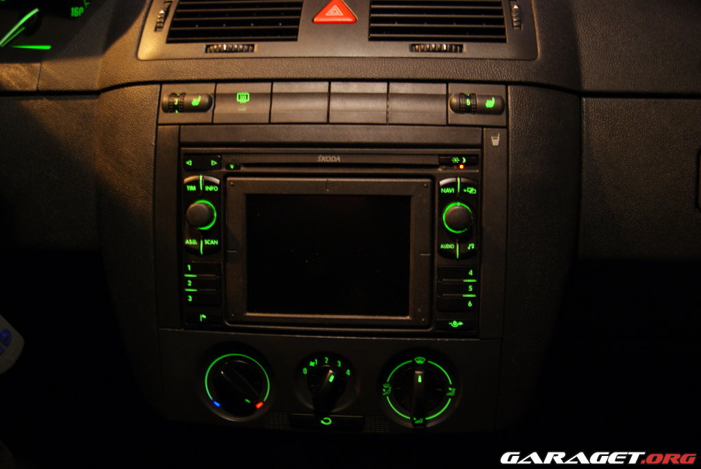

Hi just bought a MFD system and installed it into my Skoda Fabia 1.2 -2004. The navigation is very good but the MFD is little hard to work whit. Pretty bad meny system.
And installing it was no bigger problem. The gala signal was already in place so no need of cutting wiries from instrument cluster. Just simply put a cabel from the ISO to right pin into MFD (Pin5, and Pin8 on the big 26pin-connector)

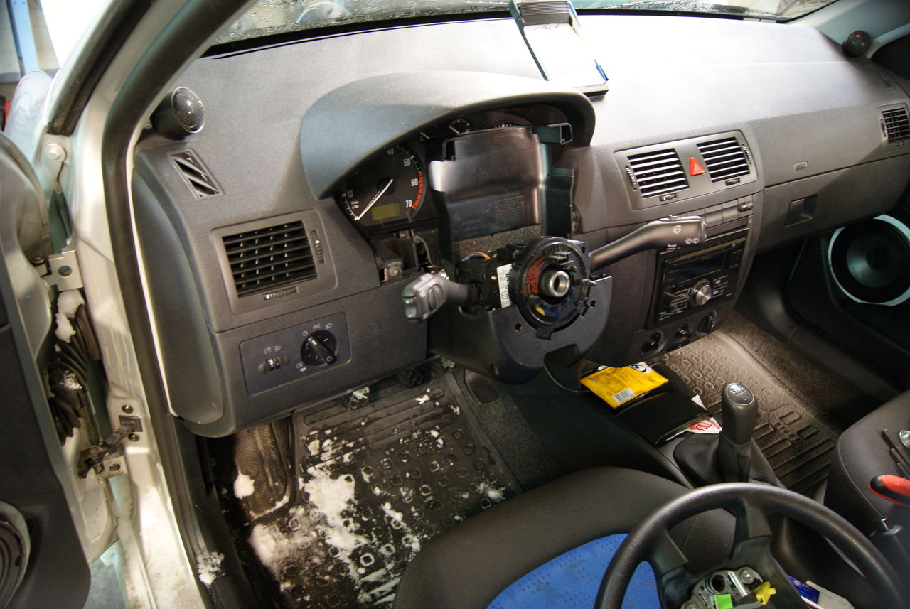

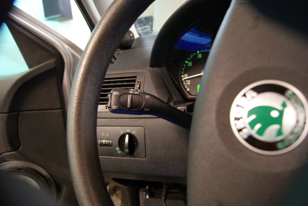

The CC was little more hard sence it needed a wire from the ECU into kupe but I did find a hole (drilled a hole I mean) at last to put that cable.

Some pic on the MFD Navi
And on the CC
While was workning on the CC
