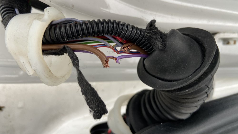

On my 2012 Skoda superb, the lights are on only when my tailgate is partially open. If I open it fully they go off and if I close it they go off, so only in a range in the middle they seem to work. Anyone with a similar problem that they managed to solve?

I would imagine the problem is straight forward-a wire continuity issue where it flexes between body and tailgate.
Hi, just saw this thread had a new post and it reminded me of posting a reply to your commwnt. In the picture you can see how the wires looked like.
it looks like hinge wires need some attention in your photo .thanks for the reply ,
