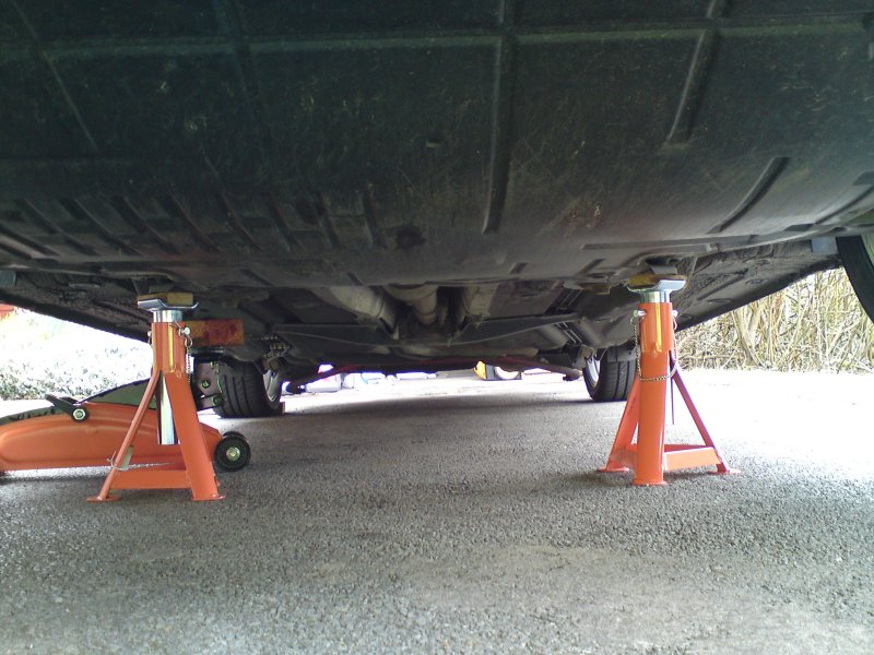

Just wanted to check to see what people's thoughts are on these locations for axle stands. I've used the back of the wishbone, with a block of oak bridging the load across the bolt head and the actual wishbone itself.

Looks good but your jack looks dodgy. If it's on the part of the chassis which is lower that the body you can damage them if you have a narrow headed jack.

Sorry I don't quite follow you when you say it could damage them? :S
They are only thin metal and with the smaller jack heads the raised parts can press into the channel. Don't know about tdi but on a Vrs they carry the plastic fuel pipes.

Ah yes, I have a 5" square block of wood on the top of the jack head to spread the load. :)
Looks fine :)

Cheers. :) Didn't fall down on me in the end! I've not really used axle stands before so it was just a bit of a confidence thing before I dragged myself under the car, but it seemed very solid though. :thumbup:
That is where I stick my stands, or on the bolt in just to the right. All depends on where i can get the jack too. My car has happily run at 60mph on stands :-)
