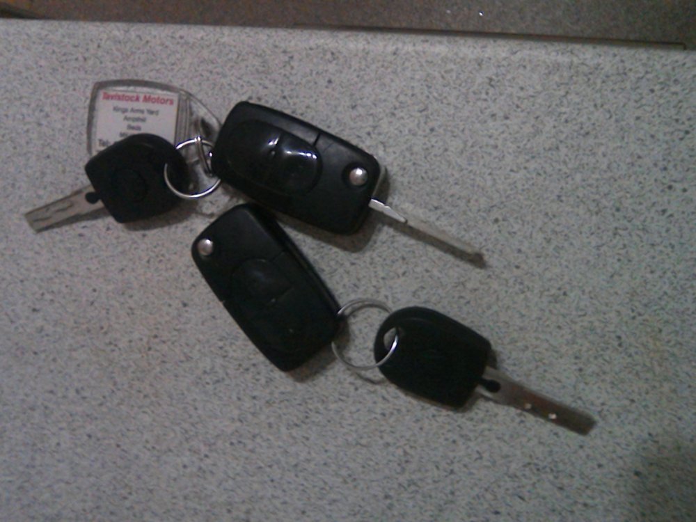

Hi,
I have the same years but I've got 4 keys, bought the car last week. 2 normal key (open the doors but can't ignition) and 2 flip fob remote key(Can't open the doors but do ignition). Both don't work I replaced the batteries. Maybe I did something wrong but doesn't work for me. Any advice?
