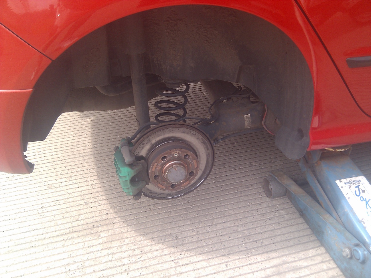

This rear brake is not normal is it, theres a big lip too, front dont look like these but theres a big lip round the disc, so i guess new disks pads front and rear then?

Can't see any photo but if your discs have a big lip then yes, most likely need replacing!
They look knackered :giggle:
That does look lind of worn yes, but it's usual to measure the disc thickness with a micrometer, not just look at the rust on the rim, which can go to 3 mm or so "above" the wearing area without cracking.
yup they be fecked
How big is the Lip on the Disc, give it a runn off with a driver to get rid of all the rust, and if its at about 3-4mm change the discs (and pads) just for saftys sake
I would measure the disc thickness with a micrometer, it may be easier to remove the pads to do this. The fronts are 22mm min (25mm new) and rear ones are 7mm min (9mm new)
The pic looks like what my rear discs were like, the pads had plenty of material left, but were de-laminating (coming off the backing plate) so new ones were required, the discs were about 8mm thick near the edge, but the garage insisted I had new ones. It was only £100 ish for discs and pads. I should have renewed my fronts last year as they were 22.75mm, however the EBC pads I use don't wear the discs down much.

Gone for new disks and pads all round anyway off ebay, same guy i bought them off when I had my octavia Vrs, whoops need to stop spending my redundancy money.
