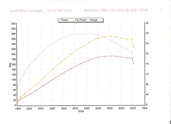

With regards to the 40 bhp increase as stated on shark performance.co.uk , is that extra power output evenly spread over the full rev range or is it remapped to my preference such as top end speed or low end torque? :)
It's very evenly spread with a fair bit of increased pull at the top end (where the standard car is quite breathless). Here's a graph that should display it a little better (click on the thumbnail to enlarge):

Really interesting curve, seems very different to standard and other remaps I've seen (which tend to mirror the normal curve but just an extra ~20% everywhere)! I'm guessing the benefits of a curve like that is that it's kinder to drivetrain components as the power comes in smoothly as you gain revs, rather than just a huge lump of torque around 2500k?
Is that an 'off the shelf' map you can offer Ben?

Smoother is faster :thumbup: We're not big on torque spikes or general aggressiveness but prefer to make the car pull cleanly and smoothly.
That graph is from one of our developed maps and so yes, even with the STS you'd be getting the same software :thumbup:

One last quick one... the graph you posted, are the units for torque Nm or ft lbs? Thanks!
The units in the graph are lb/ft :thumbup:
Is that graph from a stage 2 map?
No, that graph is from our stage 1 map on 56OctyvRS's car. I would say the graph is more important than the figures :thumbup:
That graph looks familiar lol I can confirm that it is smooth and is awesome to drive. The best investment I have made on the car to date :)emoticon-0148-yes.gif
