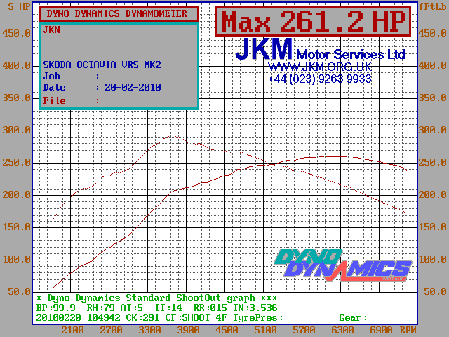

There's no dip in this one.

I somehow doubt thats just a stage 1 car with nothing else on it though

Just a couple ;) .

seen that happen on another car on dyno dynamics rollers.
i think chris car had autotech HPFP and evoms, on a revo stage 1 map. credible output as well when you consider he pretty much matched the Peak output of vRSCarls stage 2+ vRS, however carl hld that power and torque for a alot longer. It also had higher peak figures than Muckipups stage 2. Its all about the HPFP. although the torque is very peaky so on the road id wager the other two cars would be better.
