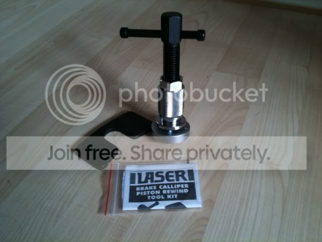

Q1 : Do i need any special tools to do my brakes eg- Brake Caliper Rewind Tool ?
front brakes no. (caliper just pushes back, just dont push it back to fast or it can damage the seals, nice and slow :)
rear brakes u will need a caliper rewind tool. as the piston needs to spin while pressure is on to push it in, (because of the handbrake)

winding the rear calipers is hardest part out of everything u listed, but with proper tool its fine

As the others have said, a calliper rewinding tool is useful for the back. You can fashion a DIY-one using a G-cramp and something y-shaped with a prong on the two stalks on the Y, but it's a bit of a pig (guess who found this out the hard way!). Oh, just be sure to fit the pads the right way 'round (one should be marked "piston" - the people who serviced my car for the previous owner [either National Tyres or the Skoda dealership] got this wrong!). I was told to apply a small amount of copper grease to the wheel hub when fitting my discs. Obviously, give everything a good clean whilst you're in there.

Picked up plug 1.85 from dealers along with quantum oil 5l for 18 quid and popped along to see my m8 that's works in halfords and got this for the price of on the house!
will this be ok for the back brakes?
