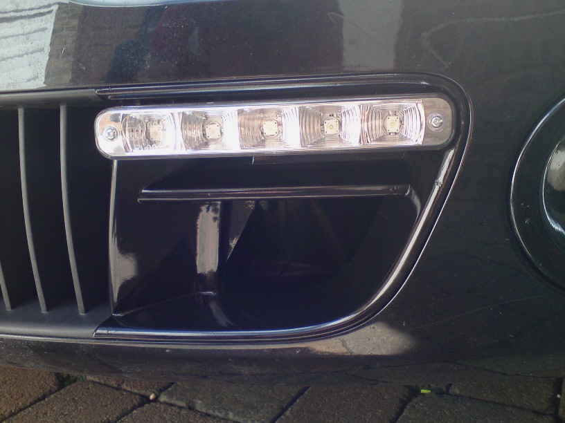

Here, and when they are fitted they look like this:

How much work is required getting them fitted?
Hacksaw job or push-out panels?
Hassle for wiring?
Asking because my experience with "mods" on a Mk2 VRS go as far as replacing the ICE with a Columbus :)
Hassle for wiring?
With a bit of guidance it is a piece of cake, the hardest part is probably cutting out the lower grille inserts, but they are only about 4 quid each if it all goes pete tong. The wiring is straight forward to, neg goes to the battery, I spliced the live in to the headlamp wiring so they come on with the ignition, then the earth is on one of the radiator bolts. :thumbup:

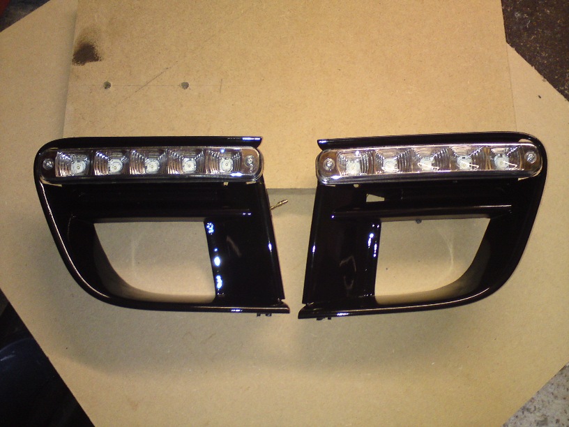

Awesome! Cheers mate
What did you use to bond the DRL to the grille bit? Also, can you just get the grille parts already colour coded direct from Skoda?

I a word.......CARP!! they are almost the same as the type Carl and I had to start with, I think Carl is using them in his boot know, I through mine in the bin.....!
The lights come with a fitting bracket that can be screwed or fixed with 3M tape (provided).
No, the grille inserts are black plastic, but as they are smooth you can achieve a very good result with a few cans of spray paint. I did colour code my first set.........
Which I also modified to accomodate a CAI pipe, but tbh I didn't like the look, so I redone them matt black which is almost the same as standard. :thumbup:
They are the same as mine, but cheaper and with a far superior plug design! Nice find. :thumbup:
May not be cheaper if you have to buy 2 of em
