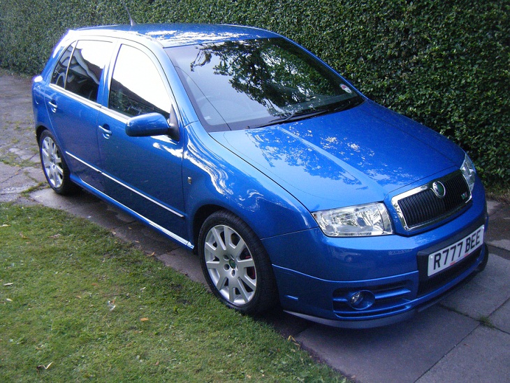

I found that the splitter was a tricky item to fit. When we went to the Vag show at tatton park a couple of weeks ago I noticed that there were loads of differant makes and models using the same cupra splitter, and none of them were fitted correctly.
When we fitted our's we found that the shape of the splitter was completely differant shape to the car front bumper. in order to get around this problem we used a high power hair dryer and set it to the hottest setting, and used this to add heat to the splitter this then allowed us to re-form the shape to fit the car correctly, this is without the need to make cut outs in the back of the splitter as shown in some of the fitting techniques.
Inorder to trim the splitter down we used a really sharp stanley knife to give us a clean finish (watch fingers).

Splitters easy to fit. Took my bumper of to do it. Trimmed the pegs down and ends down a bit, cut two V's in it to bend a little and screwed it to the bumper

heres my aerial :giggle:
Any difference in reception quality? Looks good ;)
