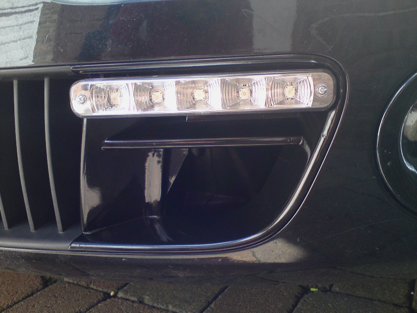

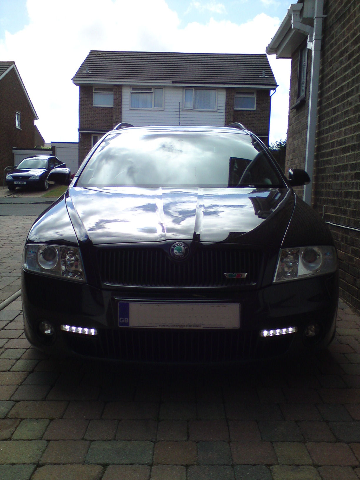

I was under the impression that the fog light housed twin bulbs, one is a fog the other a DRL, moving on, the link attached in a prevoius post shows the after market type vRSCarl installed. Having installed them myself I can advise that they look excellent, very bright and if fitted correctly give the OEM look. The only critism I have is that after a heavy shower one of the lens condensed up, so i removed it to clean it out and during the refit broke the bloody thing!! :doh: However, I have since repaired it and wrapped both lamps in black insullating tape, tbh I think it makes it look even better. :thumbup:

HTH : your lights look good, where did you get them from? Are the flush mounted or fitted on top of the bumpers?

They are by the far the most OEM looking aftermarket LEDs I've seen, good job emoticon-0148-yes.gif

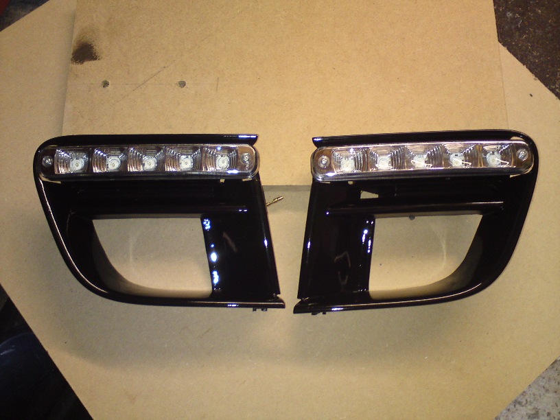

The lights are from ebay, as found by vRSCarl, I've just done a search and the seller doesn't seem to have them, maybe because I contacted them about the water ingress!
The lights are fitted as flush to the bumper as possible having inserted them into the outer grille inserts, I modified both the grilles' and the lights slightly to achieve the best possible OEM finish.
These are pictures of the original fit, where I carried out further mods to the grilles to incoporate a CAI, but I have since replaced them with standard unpainted grilles as I think it adds to the OEM look.
