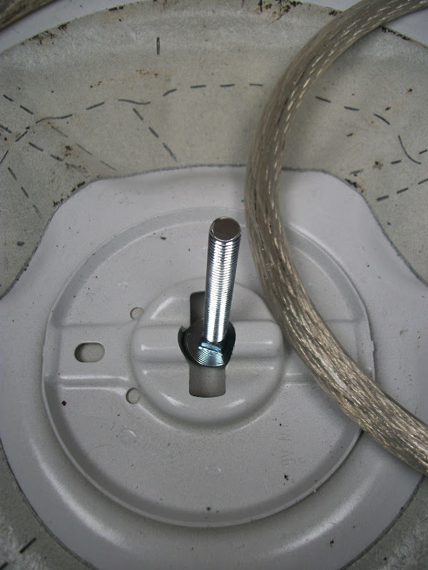

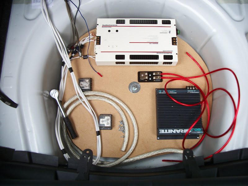

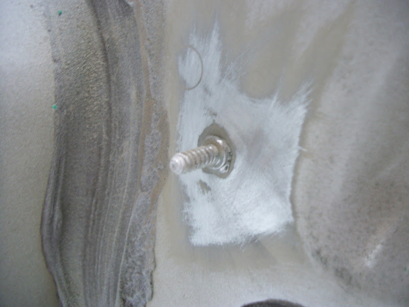

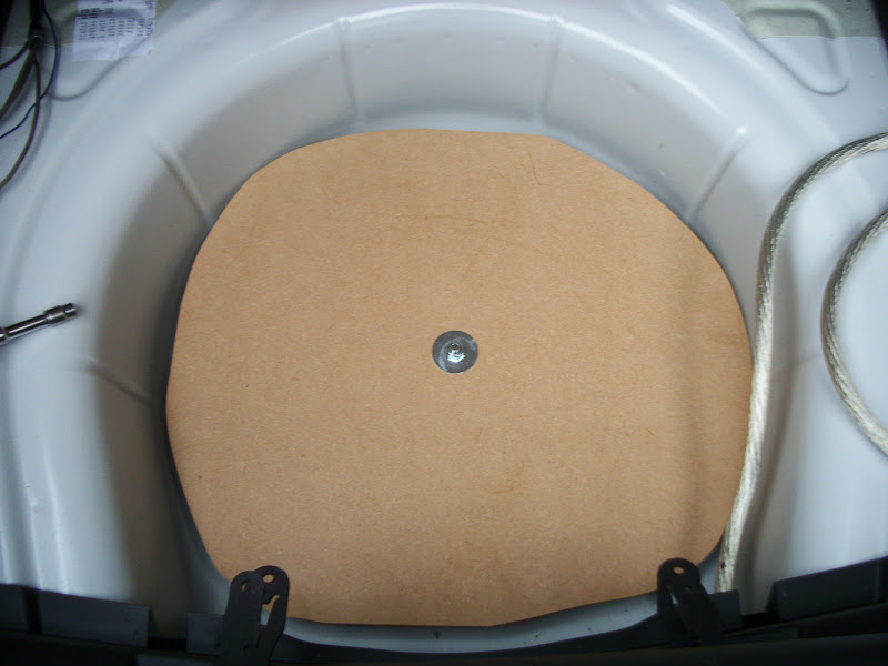

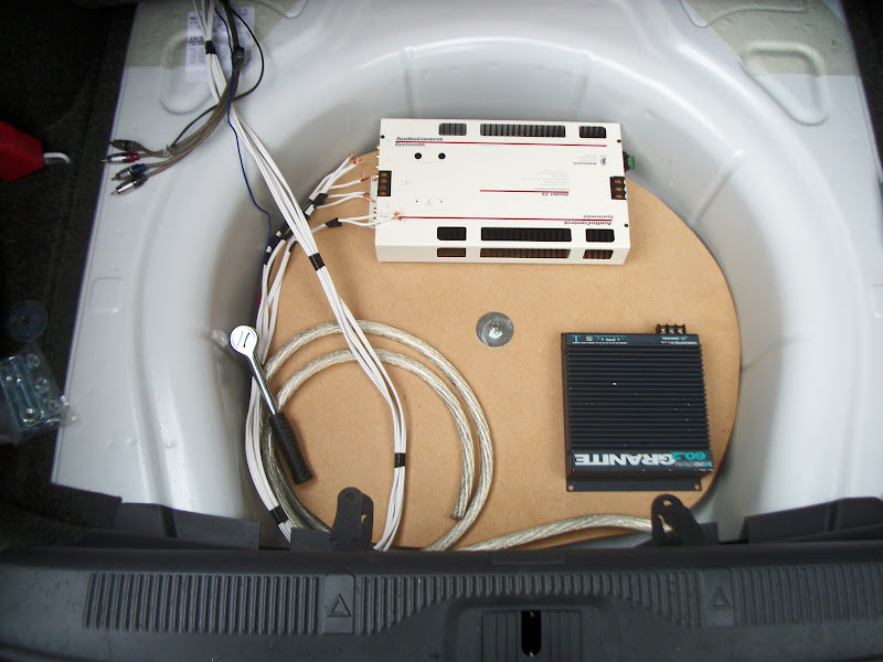

so far this morning i have wired the speakers into the factory loom up front, sorted an earth in the boot and cut and fitted the boot floor

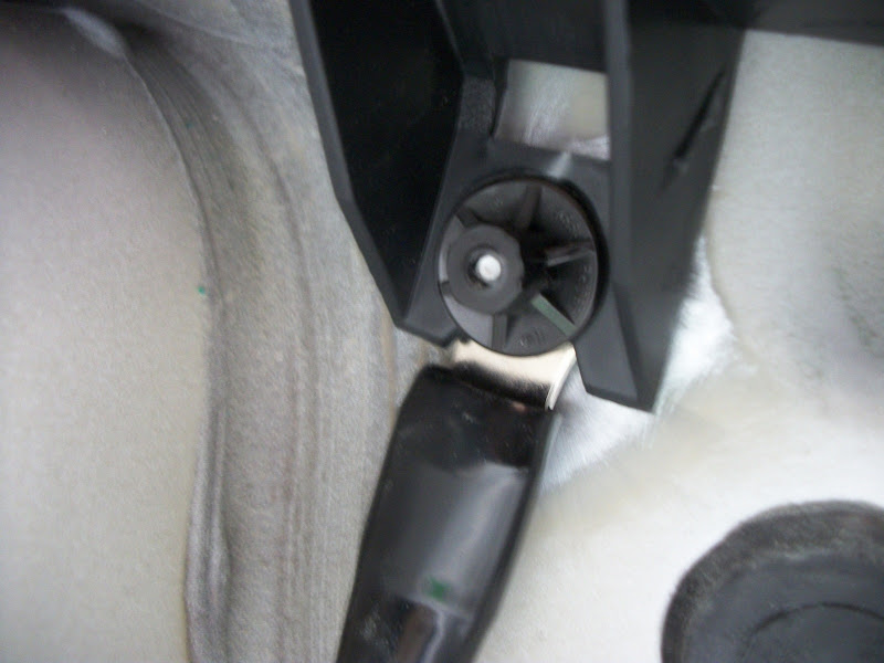

Using the boot slam trim retaining bolt
Got a washer at the base of the thread in full contact with the bare metal then the ring terminal against that
Using a large flat head bolt to slot into the spare wheel retaining bracket - works a treat

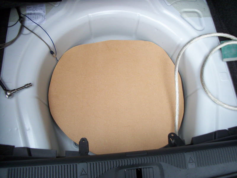

Floor cut and fitted

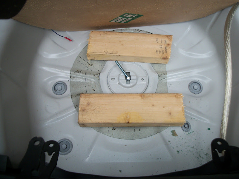

Due to the height of the bracket I have placed some blocks of wood in the wheel well for the board to rest on so its stable
when the bolt is cranked down it holds them in place and also holds board flat

what happens if you get a puncture, you using gel?
Didnt come with a spare wheel so just have the Gel in the emergency kit

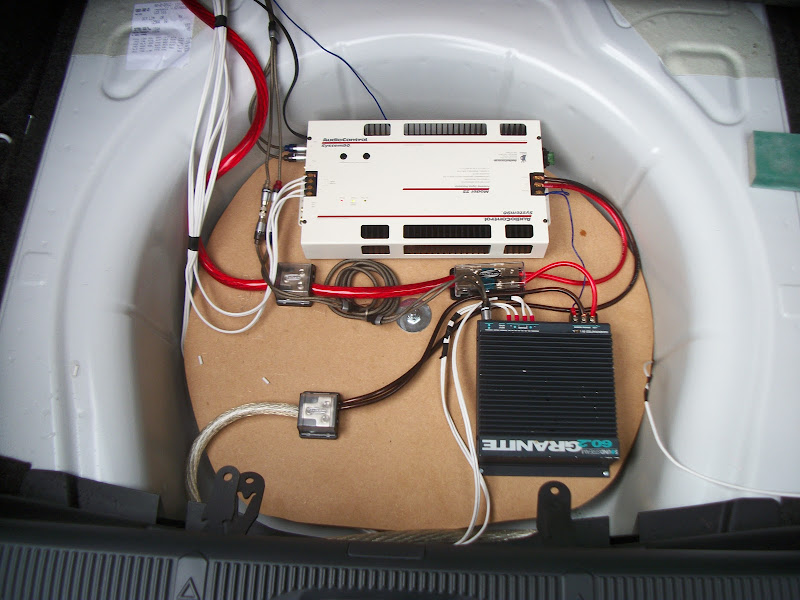

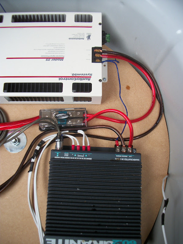

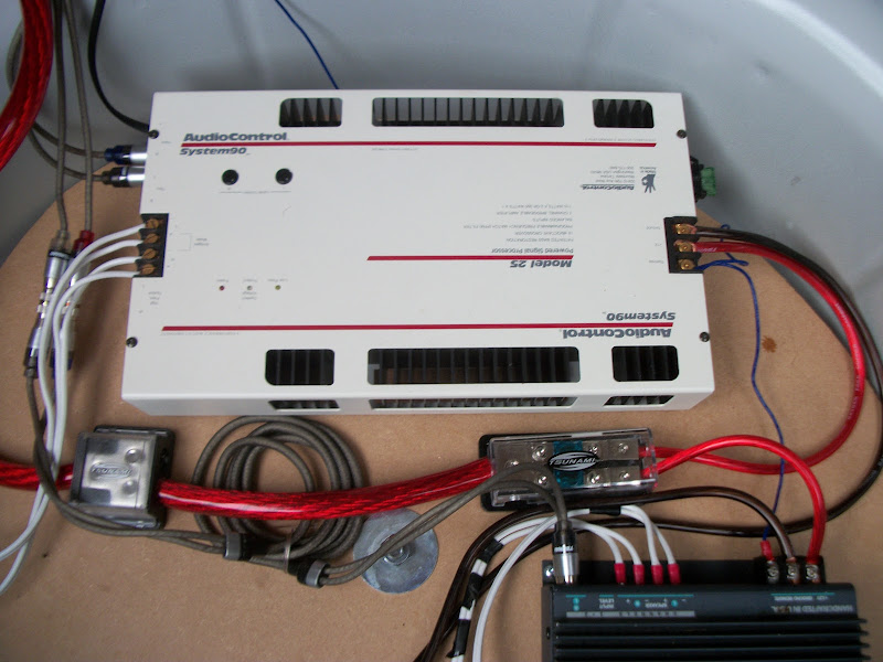

All wired in - the Audiocontrol amp powers the uprated front speakers (and stock tweeter) when it comes to adding the bass amp I will take the EPIC output from the audiocontrol - the Soundstream is running the oem speakers to the rear doors

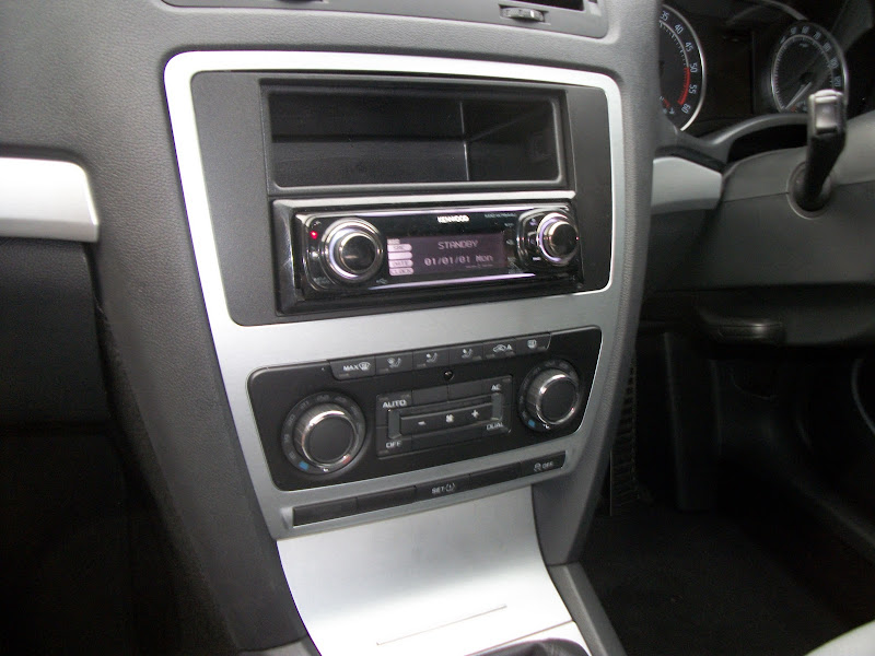

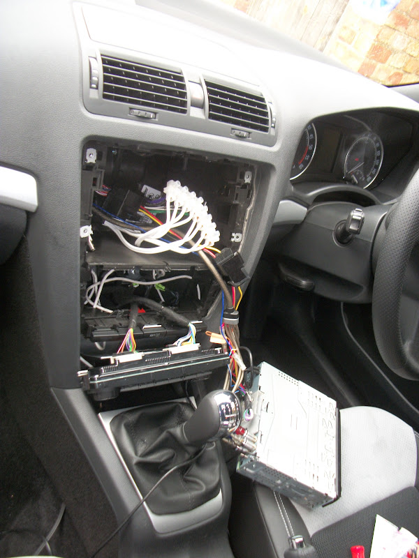

Here you can see the main fascia panel removed - the white cables are the speaker connections coming from the back and taping into the standard quadlock adaptor (using a customised loom - this prevents me having to run speaker cables into the doors myself as it uses the standard wiring - im not running big power to the speakers so it saves time - you can also see the climate control panel removed - this was so I could get access behind the small cubby hole at the base of the centre console into which I ran the Ipod connection
and here it is all back together - the ipod is hidden in the cubby hole at the bottom of the pic

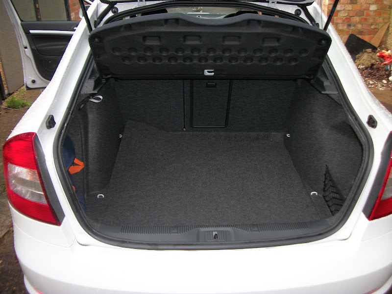

And the boot all factory fresh (apart from where the power cable is kicking up the carpet in the corner - but that will be hidden by the sub box
Im pretty chuffed with it - it sounds good and clear - certainly good enough for my cloth ears - I have a lot of miles to do this week so will give it a work out - then Im just waiting for the GZNA2800XII amp to arrive from Germany and it will be finished!

Very tidy. I'm still not convinced by single DIN units in the Octy2 dash though, seems to get a bit 'lost' with all that space? It's why I've not fitted the aftermarket stuff I had in the Fabia...
Steve
Have had this HU in an A3 Sportback and a Seat Leon FR both double din as standard and to me it looks fine - the cubby hole above the HU only gets used to store car park tickets from the payment machine to the exit barrier though

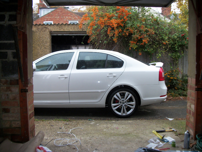

Looks great. Not really into all this ICE stuff but looks impressive. One note though, the back end looks pretty high on onw of the side pics above. Some Eibachs and the ICE weight should sort that ;)

The head unit looks so lost in that double DIN size hole, even with the blanking plate! Lol!
