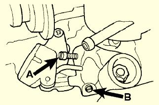

Do you know what the "hot idle" speed actually is? This sounds like the hot idle may be too low, particularly if the engine runs fine as soon as you open the throttle.
Autodata says 800 +/- 50 rpm, adjusted using 'A'
So set it to 850rpm and see how you go... :)
