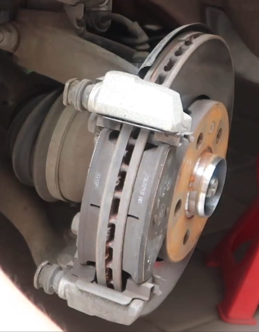

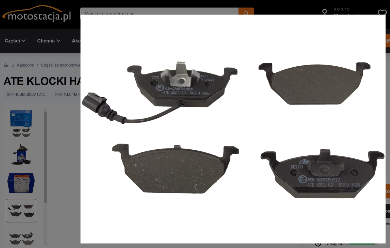

  4. I tried to record the rattling today. It is better to listen on smartphone than pc. Do you guys think that are lose pads?

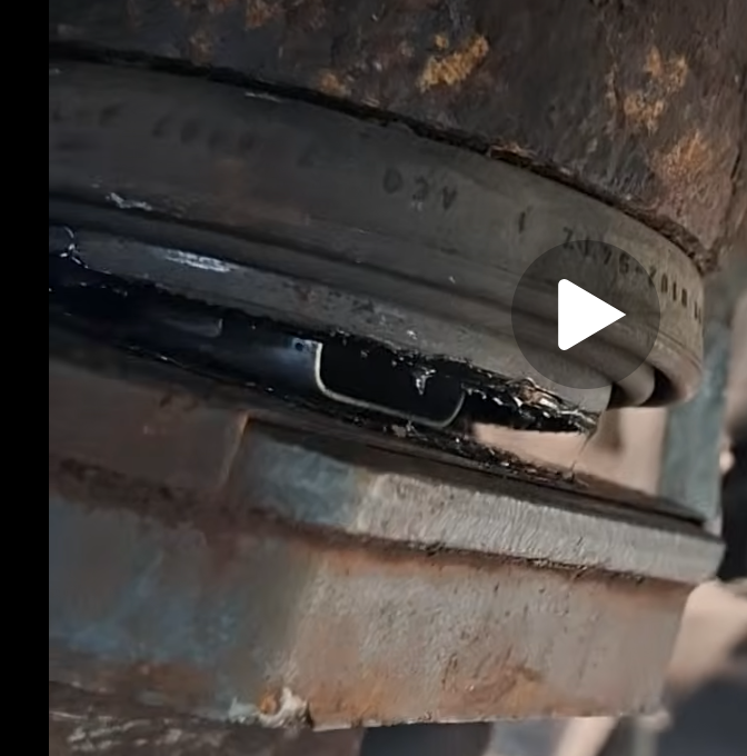

  10. Are both cables are too short now and you cannot catch nuts on the thread even if hanbrake is maximum down in zero positon? If cables seems too short now you need to push back self adjusters up with pliers or screwdriver. It will relase more cable to the cabin and you be able to put nuts on the thread.|You dont need to remove drums. You can do it with screwdriver through the lug bolt hole but it is tricki for the first time.
  11. handbrake lever maximum down, put the nuts on the thread self adjusters up with screwdriver put the drums on pull handbrake lever and tight the nuts more if lever is max down cable must be a little lose
  12. so now lever down and tight the nuts until first touch. If you pull the lever self adjuster should sink down deeper and deeper. Shoes should expand. Its greased dont expect much braking.

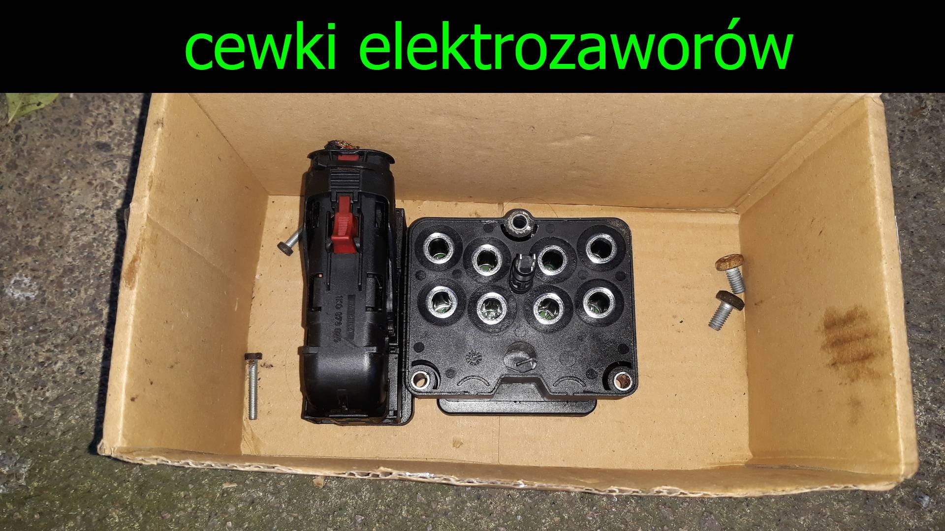

  13. To be honest I cant hear relay ON click because is masked by turning ignition. I can hear OFF only. What if you remove relay and try to turn the key to the ignition position? Still pump works without relay? If yes I would check cable from relay output to pump. Maybe there is just another jumper cable from lighter to pump.
  14. Maybe he connected legs of relay. Can you hear pump relay disconnecting after couple of seconds? Or maybe there is no relay just jumper.

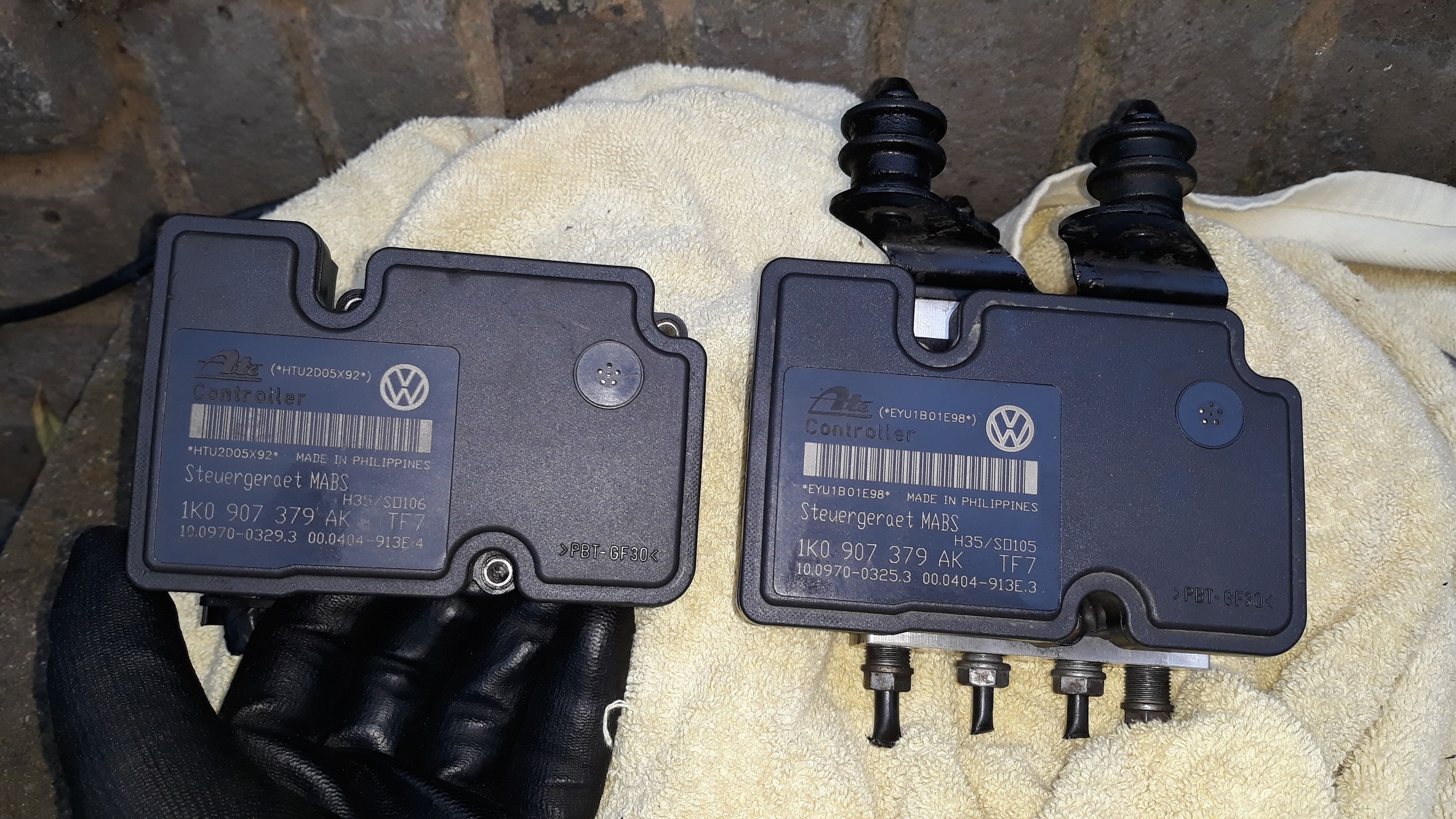

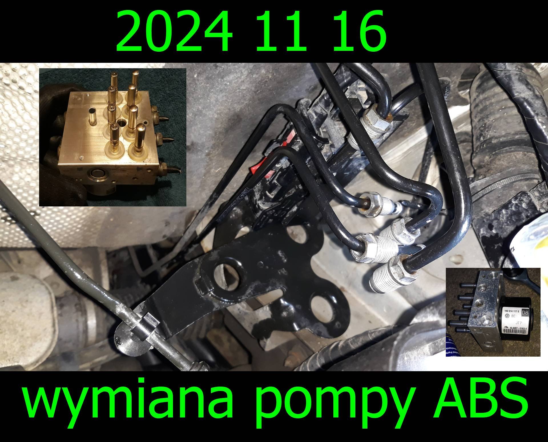

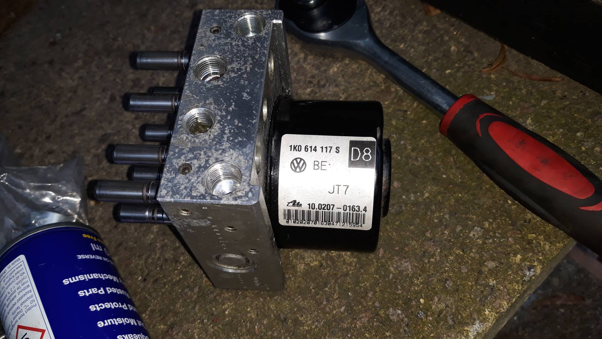

  15. this way dirty fluid behind the piston goes back to ABS pump against pump filters. In this circut pressure from calipers is nor normal operation. You were lucky 😊 Well you help bleeders to weld with caliper forever 😉
