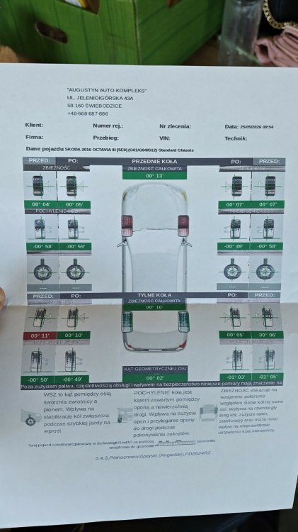

I have winter 16" and 17" summer, both genuine without any adapters.
What about geometry?
Geometry on point, if it was slightly off i would get vibrations at higher speed especially.
