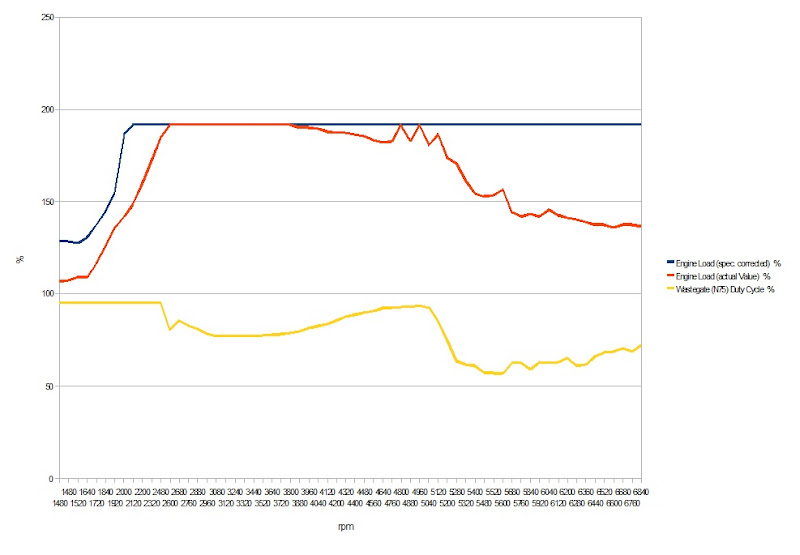

Interesting to see that the AFR may be a sympton rather than a cause. I should say that fuel trim figures on Block 032 of VCDS seem a bit worse than with Stage 2 where they were both near zero (now -1.9% and 5.1% so still nothing drastic).
I think I will run the car down to JKM to get some diagnostics done and swap out the various sensors as we go in a data-driven way; I don't really want to go down the same route as VRSCarl and swap one thing after another only to be not much further forward. I would probably leave out the N75 for the moment as it's a beehatch to get to.
What I may do before that is get the VCDS cable out and log a few things to include engine load and actual rail pressure again (in case it could show if the fuel pump was 'cavitating' as Ben says). I also have an old MAF sensor kindly donated by Simon. If I see something, I may use the STS unit to take the car back to the old, original Pendle Performance Stage 1 although the demands of that may no show the 'load problem' that a Shark Stage 3 would. It may be futile but worth a shot before spending more money at JKM :p
Here is a graph of Actual/Specied load and N75 taken from one run using the data JKM got with the intial Stage 3 version, if it is of interest / help:

I'll look into that Ian. There will be nothing monitoring the pump itself as its a contant thing but I forget if there is a pressure sensor on the low-pressure side.

Unfortunately its impossible to see a failing N75 from logs.
The duty cycle is the control duty cycle from ECU, not the actual valve duty cycle. There's no feedback loop on the actual duty. When N75 starts to fail, it begins to respond a bit slower, sometimes causing such problems as we're seeing here.

Ahh, thanks Mikko. I will move the N75 up the 'to do' list as I investigate what's going on.
Can you offer any advice as to what the best way to investigate what you are calling 'load control'?
Since its just about impossible to test the N75, and failing valve is very common on these cars and often causes such behavior as we're seeing in your dyno runs, I would change that before doing anything else.

Dave if you post up the last set of logs, then once you get a new set of logs after map updates we can see the differences.
in hindsight, it would have been handy to have ran your car with timmys MAF sensor on the recent jkm RR day. that way you could compare top the RR day on the 5th that we went to.
