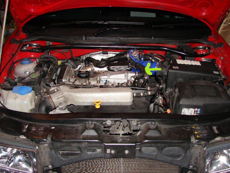

probably totally not relevant but I have been having simialar problem on my Octavia 1.8T which I think I have sorted this problem as I have said it probably aint relevant as I dont know the diesel lump but on engine there is sort off a Y shapped piece of rubber that comes some where from the back of the engine and then splits into two one end goes straight to the top of the engine and then the other down in front of the engine. The one in mine that goes straight down towards the front of the engine has perished and become totally detached at the Y section of it. I have bodged it and the smell has gone.
As I said its probably totaly non relevant but hey its worth a 30 second glance.
just nicked a piccy from a member on here to show as I looked back at my post and it didnt make sence to me :giggle:
green arrow marks the spot :rofl:
Pete, look at the hose that leads off the egr valve towards the bulkhead, it wears a hole on the engine cover, hth.
