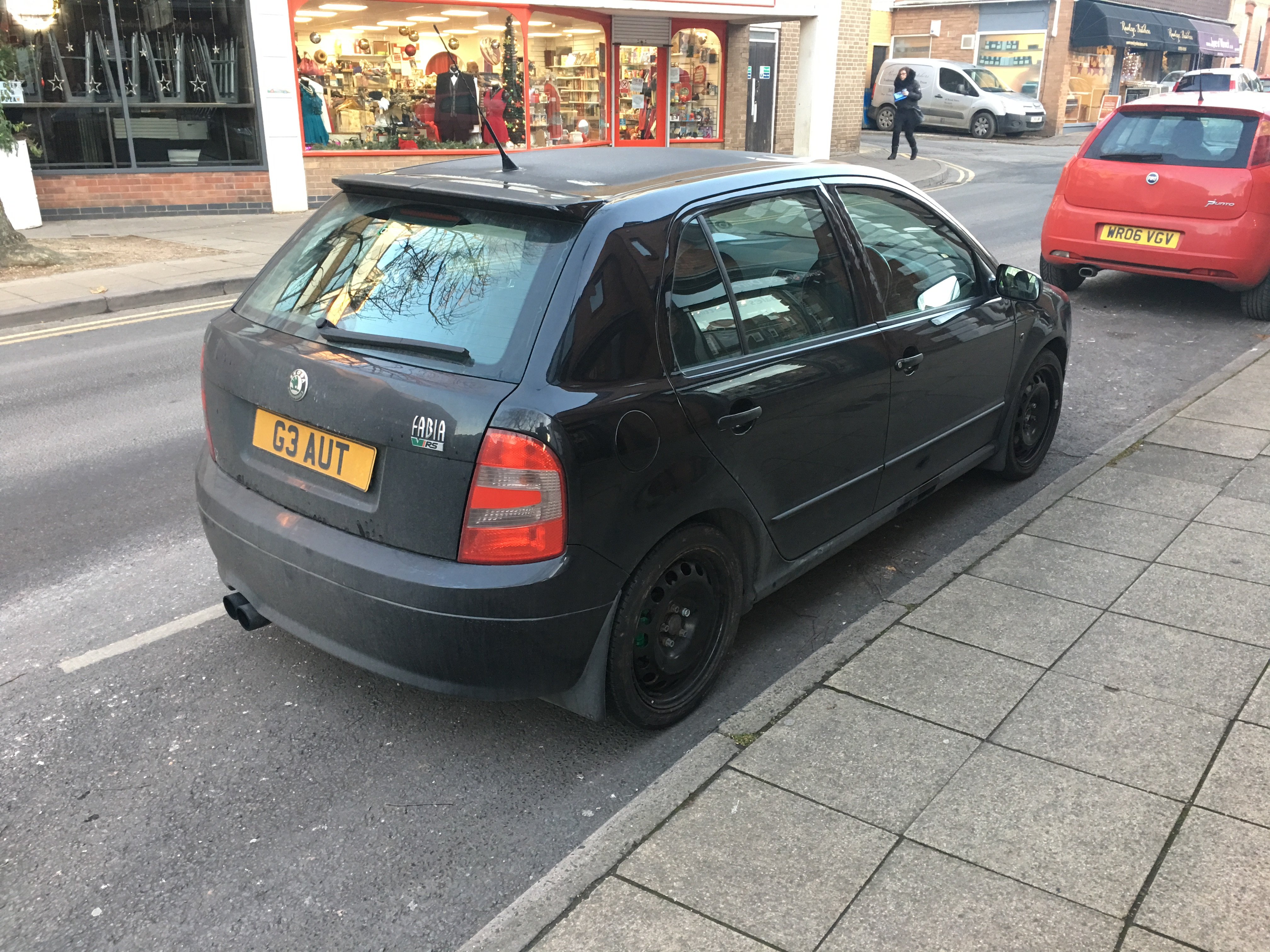

I needed a set of winters for my daily Vrs, so purchased a set of 4 x original Fabia Vrs spare steel wheels in the 16” size, paid £40 for all four then fitted a new set of 205/45/16 nankang snow tyres.

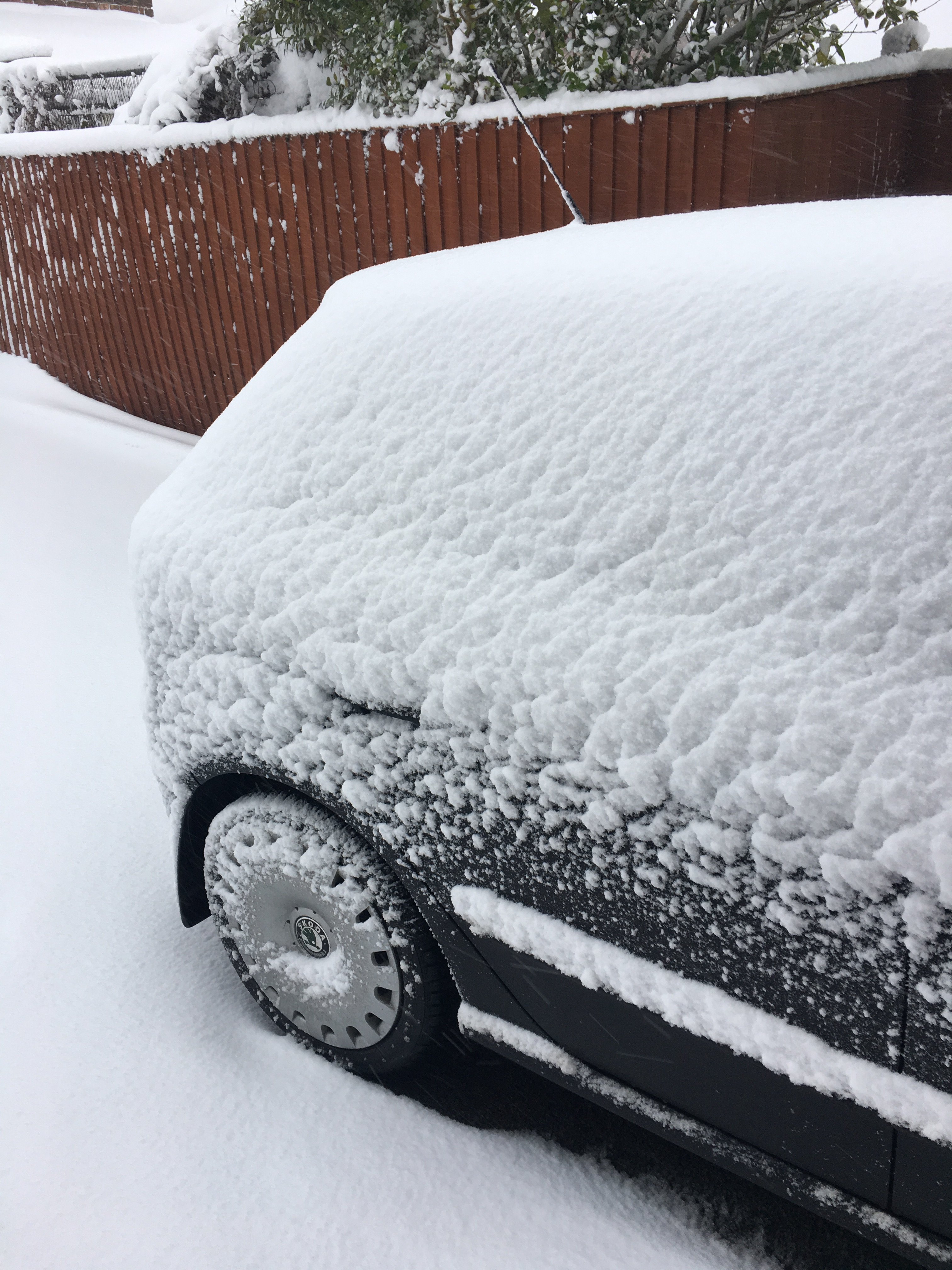

Looked pretty grim on bare steelies so I sourced a set of early VW Bora 16” S wheel trims, and changed the centre badges for some cheap skoda domed ones off eBay, looks half decent now!
Obviously transformed the car in the recent bad weather!
Incidentaly the Fabia standard steel spare wheel is exactly the same as those fitted to various VW models, such as Beetle and Bora etc. Plus the radius seat wheel bolts are a direct fit.
