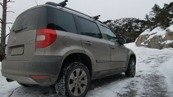

I went for the Skoda bars (as pictured) since they don't stick out past the car's bars as the Thule ones do. The car's roof bars have preset positions for the bars so you can't move the front one. The back one has two positions but only about 70mm difference between the two positions.

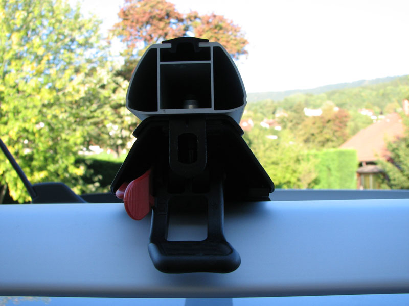

The Skoda roof bar rack fits by screwing two special 6mm hex-head bolts into tapped holes in the side rails at each mounting point. Then the cross bars lock onto the bolts so that the bars can be easily removed (in the interests of fuel economy) when not required, leaving the bolts in place.
As far as I can tell, the cross bars don't actually rest on the top of the side rails, all the load is taken through the bolts. The capacity of the rack is limited anyway, as the mounting positions for the cross bars are well away from the point where the siderails are fixed into the roof, as you will note in the photo.
As I'm only making occasional use of the roof bars (for a set of amber beacons for motorsport and occasionally carrying an extension ladder locally) I made up my own rack using four brackets 110mm long made of strong (but thin) steel angle (old galvanised steel CH radiator brackets) drilled to match the mounting holes (60mm apart) and then mounted old Paddy Hopkirk roof rack crossbars onto the brackets. Just like the Skoda rack, all the load is taken by the bolts screwed into the tapped holes in the side rails, and the whole outfit seems perfectly secure. However, I'm not sure I'd want to carry anything of significant weight at high speed or great distance - for which I'd want the genuine Skoda rack!

Here are some detail pics from the French forum. You can see the bolts on these pictures.

Mine was not tagged Yeti... it is for any VW or Opel product and has a more rounded tip - see here on eBay. See attached of mine.
I bought the Thule roof bars and I don't have a problem with them, either with noise or sticking out too far - and you can vary the position a lot more than the official Skoda ones (although to be honest, I use the Skoda mounting points as a guide when I put them on!)
