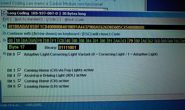

Hi all, when my car goes in (again!), I'd like to ask them to activate the corner fogs and setup the fogs to come on when leaving/coming home. What do I need to tell them code wise? Thanks.
My experience: they won't know what you're talking about, let alone be able to do it for you.
I had my cornering fogs enabled by a friendly briskoda member who is local to me and has the vcds software - suggest this approach is going to be more effective than a dealer.
Not aware of the other thing you mention? I have "coming/leaving home" lights but these are the xenon/ dipped beam and enabled via maxidot - not aware of an ability to change this to be the fogs?

The coming/leaving home function turns on/off the lights automatically to illuminate your driveway.
Xenon's do not like to be switched on and off repeatedly so some have questioned if it is possible to use the halogen fog lights instead, which I understand from another thread is possible.
So, no you wouldn't need to manually turn off your fog lights and therefore no worry of breaking any laws.

I have fog lights as CH/LH and I did it with VCDS. You do not have to switch them on or off once in the car as the light switch has to be on Auto. It is much better then having Xenons on and off.
Cornering Fogs are also very good if you drive through twisty or slow roads with slow turns. Really gives a better side voew as you turn the steering wheel.
Do them both but as suggested try to find a local VCDS member to your location as the dealer will probably either not bother or charge you and play stupid.

Here is a picture from VCDS about Fog CH/LH. Light switch needs to be on Auto.
Cheers for that, do you have the screen shot for the cornering fogs? Ta.

it's a few clicks away from fog CH/LH.
