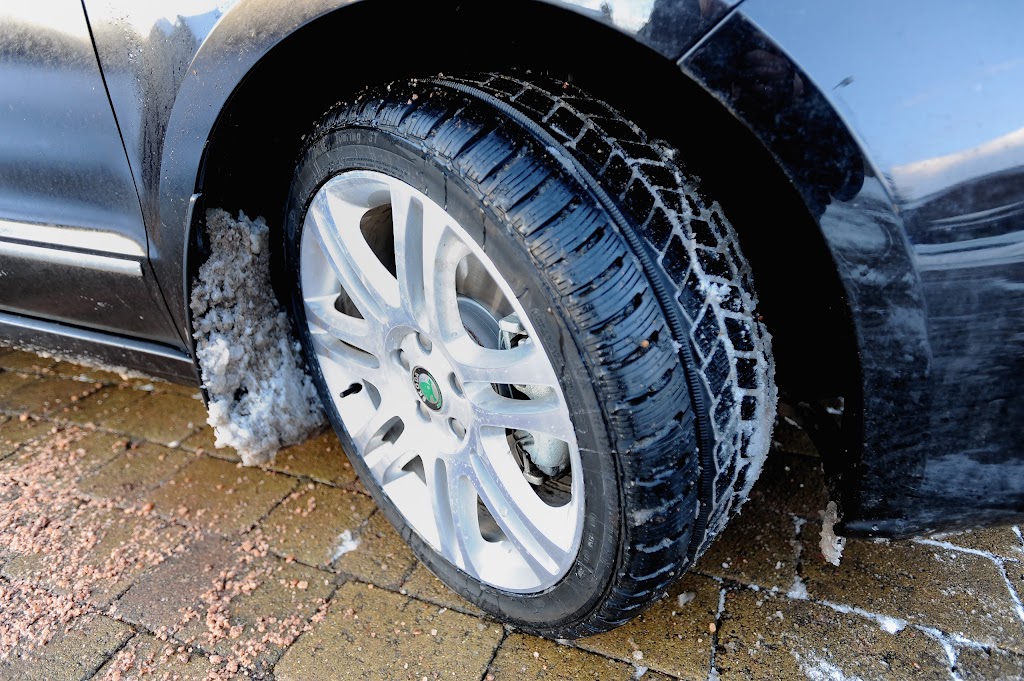

I fitted these to the 18" Themistos.
Avon Ice Touring. Around £140 per tyre.
Phil.
Edited by philpix
Cool, can I ask how much for the set? I will get some for next winter. I will order in the summer time I think as I won't get my Superb till March/April time.
Also what make did you go for?
