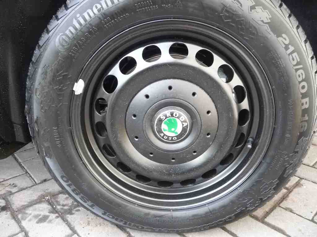

I was lazy and just bought those on 'buy it now' I paid about £20 delivered approx. I have ended up buying 2 sets, as 2 of the first set I bought were not a very good fit (broken slightly) and fell off. 1st one within 500 miles, the other after about 2000 miles.
The ones I have fitted at the moment all fit properly.
The wheels & tyres are a little dirtier now. This was taken at about 15miles old
My link
