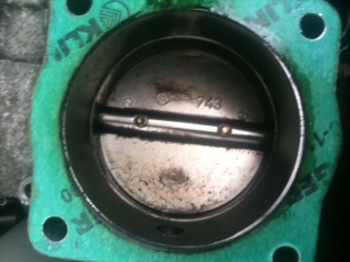

i had a go at the throttle body clean today and what a difference it has made. big thanks to chicken eyebrow for the very helpful guide on here as well. :thumbup: not really a surprise it has made such a difference when you see the state that it was in. is this possibly the dirtiest throttle body on a mk1 vrs you have seen??? :giggle:

that's nothing compared to what mine was like mate, mine was completely black with no metal showing.
Yeah mine was worse than that, not completely black though!
Mine started with running troubles and EML came on after 97k on an 02 reg.
8 months ago I cleaned my TB and now it looks just like yours
the car is an 02 plate and covered 48k. not much but then again with no motorways where i am, im guessing it causes abit more grub to build up on the TB.
yeah i really think that it needs to be done every 6 months but seeing as i dont have the time on my hands with a new born baby im going to try and do it annually :thumbup:

Mine was much dirty than that,my mk 1 vrs had done 130k though.It did make a big difference to the cars running! :)

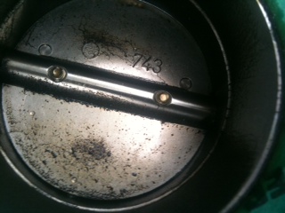

cleaned my tb today ... 118,000 miles later and it looked like this ( see attatchment )
cleaned with 3-in-1 degreaser and worked a treat ... car drives like it did when i first got it :)
another pic of the dirty hole :)

I see your point , but I would imagine that it may been that the air passing through the throttle is smoother and less restrictive with a shiny internal TB as apposed to a carbon up rough TB that airflow would hit. Also it the TB is really carboned up then maybe the TB is not opening up smoothly.
theres a float inside thats coneccted to the accelerator pedal ... if its carboned up it sticks hence the rough tickover .... mine was rough tickover when i startd it cold , didnt like running till the choke had completly dropped offf and the revs use to drop off them come back when the choke was on .. also i had a 'black spot' when i put my foot down and the revs wasnt constant on tick over after it got warm .. car has full service history and all filters changed regular ( inc MAF ) ... the car runs smooth now on tick over when cold and when moving .. it had a few mm's worth of carbon in it and took me a good hour to remove it .... when i picked the gasket up from skoda ( had to order it in and hadnt a clue on the part munber for it .... good job i took it off here :) they admitted that they ' cant be bothered to strip them and clean them' hence why they tell u that u need a new TB at a cost of £300+ ... it cost me £4.46 for 2 gaskets ( i kept a spare )
That's what I found, I had my missus hold the accelerator whilst I cleaned it and it was not very smooth before cleaning and silk smooth after :thumbup:
It's definately not a placebo thing, before a throttle body clean my EML came on and i had two error codes, one of them being the common 17705 code that everyone dreads.
after new gasket and throttle body clean only the EML light remains off and no fault codes..... thats after 3 months.
