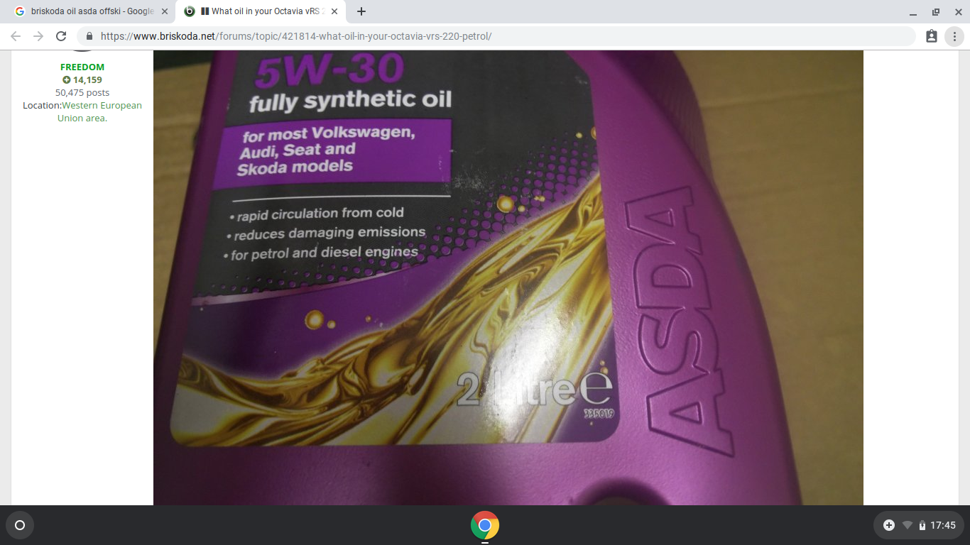

Using the incorrect oil would be stupidity.
VW 504 /507,  so 5w 30 Full Synthetic / Long life.
Somebody with a 1.6TDI CR with over 100,000 miles on the original DPF will be along hopefully.
