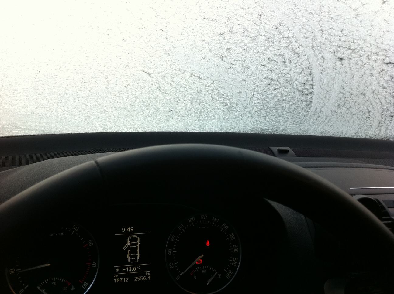

I have a FL Scout 1.8 TSi and it is really fast on defrosting. Here is a pic from yesterday at -13C. Within 7 min of idling the car i get warm air and the inside is fog free, windscreen was wiped after 7 min with wipers and it got completely clear. Rear screen takes 5 min to defrost from ice. I leave the recirculate button on till the air gets warm then once moving or not, i switch off the recirc.
