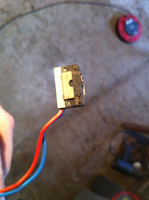

The microswitch is attached to the door lock/catch assembly inside the door and it's often the driver's one that fails because it gets the most use. Not sure if Skoda sell the switch separately because I'm pretty sure it's considered an integral part of the whole lock/catch unit, but I've seen the switches for sale on ebay. You'd need to cut the old switch off and solder the new one to the old wires. I know that some people have managed to adapt other microswitches to fit too. Might be simpler (but more expensive) to replace the complete lock/catch unit though, depending on your ability/budget.
It's such a common problem that I reckon the switches must have been made out of chocolate :S
Have attached a pic of the microswitch that another member previously posted so you can see what it looks like...
