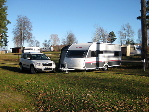

Very good towcar
Solifer Artic 560 MH (1400 kg)
0.85 to 0.95 l/mil with caravan (33.2-29.7 mpg [i think]) At 80 km/tim (50 mph)

Didn't you used to have an Adria?
That looks nice.
That looks nice.
Yes. But now I have a Solifer Artic -11.
