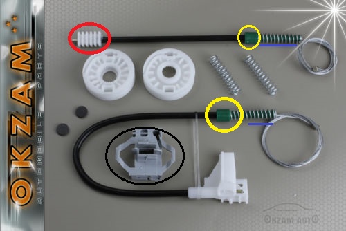

I have 2000 Skoda Octavia, and the window clips (used to be green) keeps breaking with minimal use for all windows.
And in my last repair at the workshop, it EXPLODED while driving, and heard it shattering everywhere inside the hollow door.
Its costing me around 20 euro per door (only for this clip and service charges), but there's no point in fixing them if they keep on breaking.
Can you please help in how i can fix it once and for all? replacing the clip with something else? Or maybe another system that can work in my car that doesn't fail that much?
Please refer to the picture below.
The clip that is breaking is it the one in black circle, or is it one of these in yellow circle?
If one in yellow circle then you must give attention to the following when setting up the repairing kit (I have broken one with missing these points and spent 10EUR extra for the a repair kit):
The part in red circle is used to tighten the springs (beyond the blue lines) on the green clips (those in yellow circle). How to properly tighten the springs: When the clip in the black circle is somewhere on the middle of its moving track, then the clips (those in yellow circle) must be in their housing (the plastic part on metal electric motor holder) by approximately its half (both of them). And of course I would advise you to test the window regulator setup after putting in the repair kit before you put back the door trim. Also if the reparation procedure is not done by yourself, monitor the mechanics work because they used to be very clumsy when doing such "easy" stuff...
