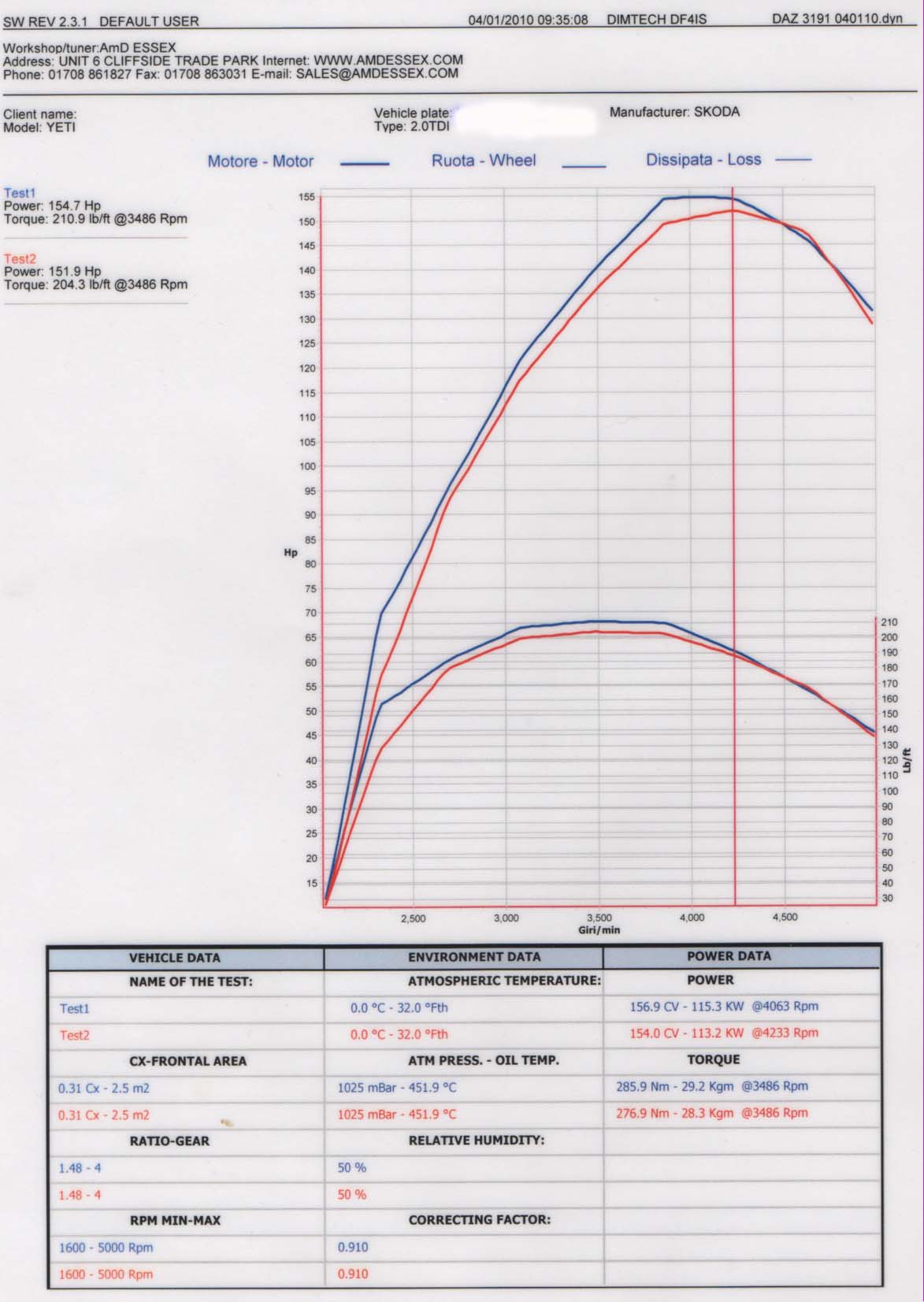

Interesting graph Johann,but what about the power and torque below 2500 rpm? You don't appear to have any below 2000rpm,or is that just a quirk of AMD's rolling road? :wonder:
Interesting graph Johann,but what about the power and torque below 2500 rpm? You don't appear to have any below 2000rpm,or is that just a quirk of AMD's rolling road? emoticon-0112-wondering.gif
Mike's looks the same (albeit being higher at the top!). I don't know how it works! But every car tested had a graph like that.
It's the way they test them.

Hopefully this should be my graph
