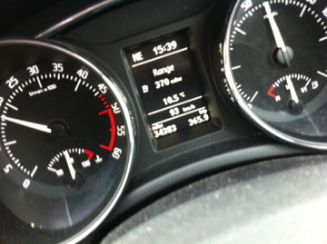

Just a quick shot from my dash (taken by passenger of course! ) showing the trip reading of 365.9 since filling up and a range remaining of 370 miles - you can see the fuel gauge just on half - I'm a very happy Superb driver. :thumbup:

I do a lot of short journeys and the best I regularly is just under 500 miles from brim to 50 miles left in the tank. although I easily managed a theoretical range of 600 miles during a fully loaded trip to Germany last summer.
Yes, thanks to the high quality optics in the iPhone camera that does indeed say 820 miles emoticon-0144-nod.gif
